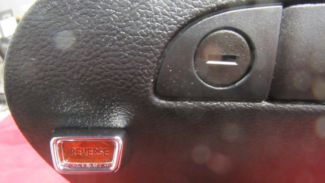

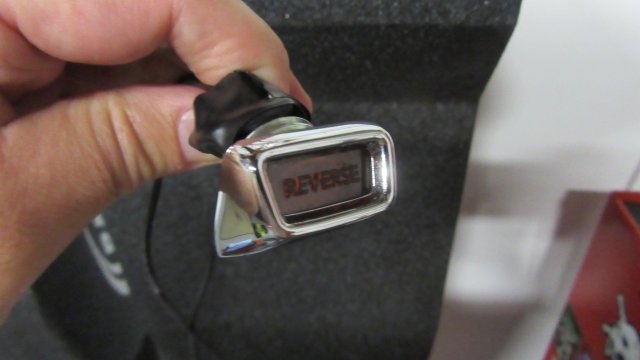

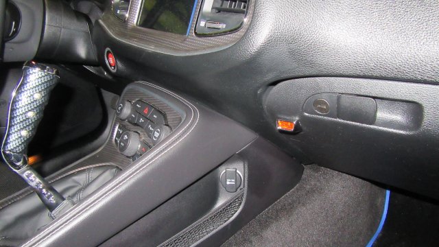

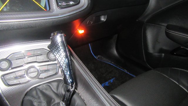

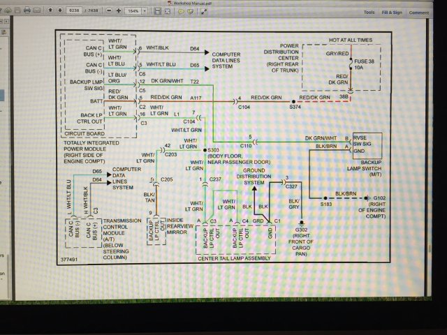

Project complete. The reverse indicator light is in. If you decide to do this to your car, I suggest you do what I did. Buy a used glove box door from Ebay and drill through that one. This way, someday in the future if you don't want the light there anymore, simply install your original door. This is something that can be very easily turned back to stock if you change your mind.

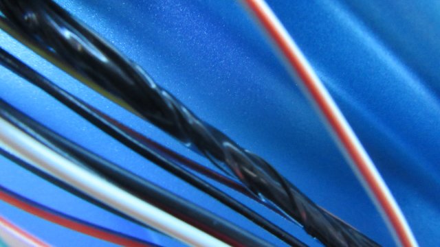

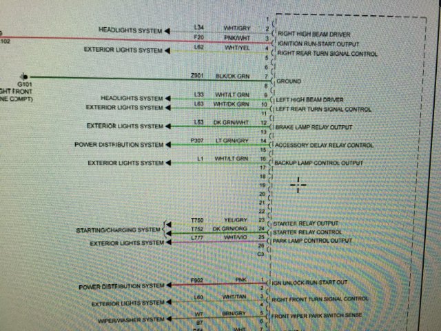

Under the trunk lid pull down the cover and locate the bright white wire with an orange tracer. Tap your power from there. For ground, open the glove box door. Look for a black phillips head screw on the left side of the box itself (not the door). I used that screw for ground.
Hopefully at least one person here will find this useful.
