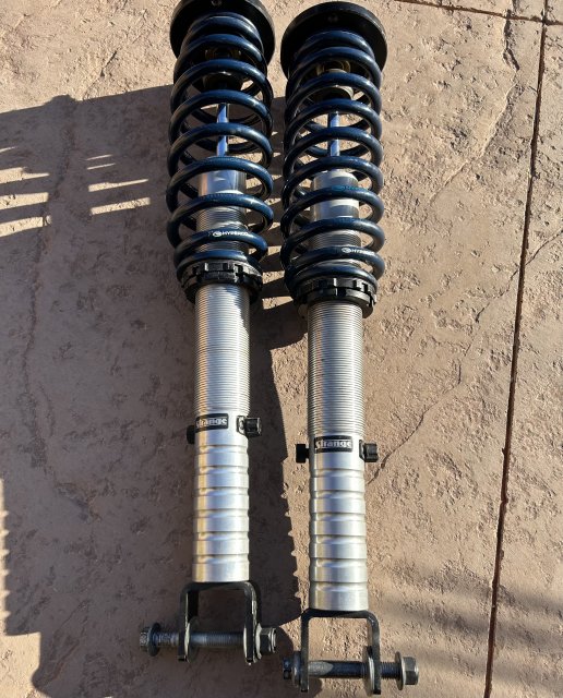

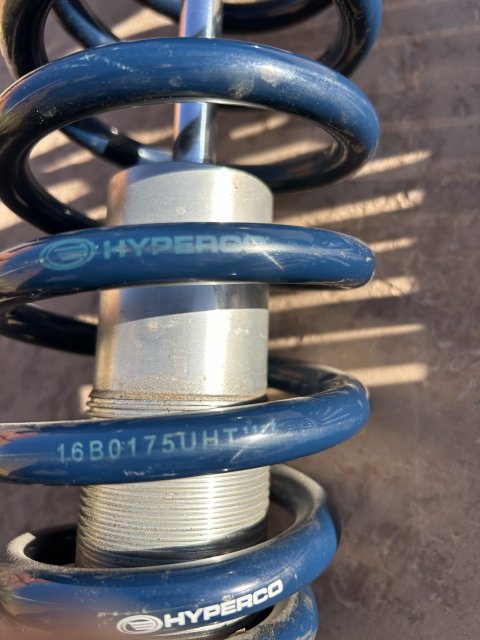

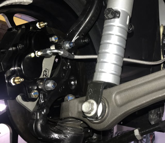

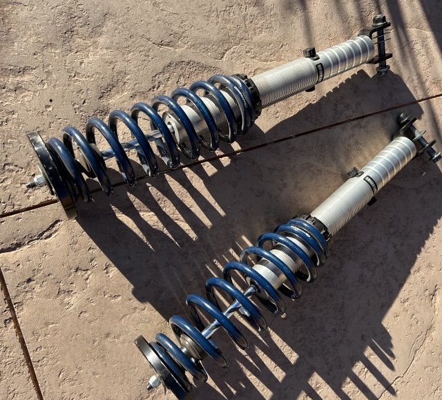

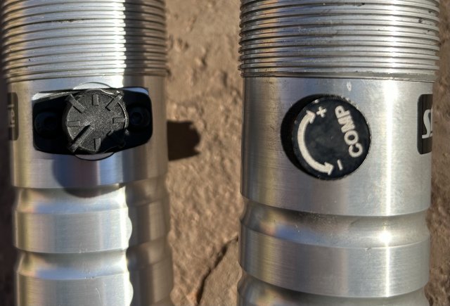

Strange Engineering adjustable coilovers. These are the shocks that came on the Dragpaks back in 2015. That’s the suspension I had in my car and it worked well. High 1.1 sixty’s with these things. They are light weight (15 lbs) and are 20 way adjustable. That is 10 positions for compression and 10 for extension. The springs are 175 lb 16” Hypercoil. That is what I ended up with after testing with the weight of my car. Mensers run a little over $2000 plus tax and shipping for the front set. I will sell these shipped for $1000. There’s one catch…. These are for the narrow early challenger lower control arms. The later model Hellcats are a little wider. Three ways to deal with that….. buy or scavenge a set of the early 2010 era Challanger control arms like they used on the Dragpaks. That’s what I did. Or you can buy a set of the narrow AAD arms that they offer for these. That’s the way more bitchen (and expensive) way to go. Or you can machine or grind a little off the attachment points on the stock arms. That’s what we did on the blue car. Anyway…. These things will allow that front end to come right up and give your drag hellcat that weight transfer you need on the starting line.
