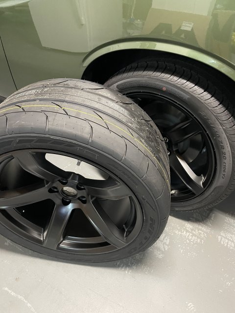

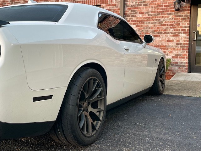

I have run the 305 Nitto’s on the stock 9.5” wheel but they do bulge some. Ended up using 10.5” wide Voxx replica wheels & they fit perfect.

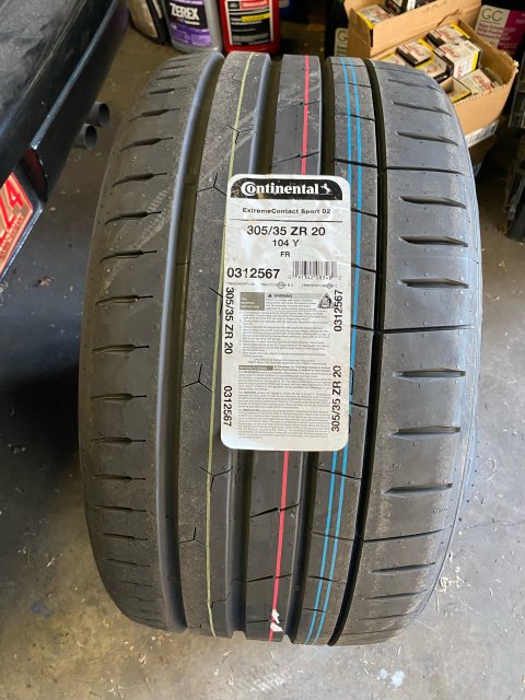

...and if you are going to do a 305/35 you could also run a high-end street tire like the Michelin PS4S or the summer Continentals, those are about the only two I would consider.

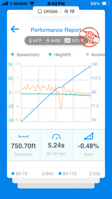

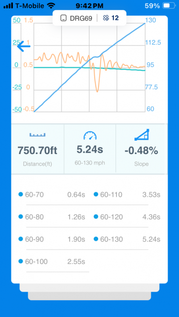

Run these, did my best street 60-130 on them after running Nitto’s for years. They last 3x as long too. Beat the Nitto’s by 1/2 second.

Mag my street set is the 305/35/20 555r2 on 10.5s and 275/40/20 555g2 on 9.5 fronts. I do like them (a lot), but I may go with conti next for street like @16GoManGoHC2 ^^^^
Thanks for the reply. The loose wheel is the replica 11 inch? Which Nitto is that? The 35R20 or the 50R20 (looks like the 35 to me)?
That is a 10.5 Replica wheel & the 305 35 20 Nitto 555 R2 tire.
