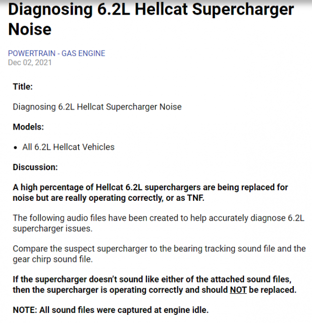

Mine has started making those bad bearings noises. The dealer is honest and trying to help, but I’m being told, in so many words… We hear what you’re hearing but our engine tech says it’s functioning properly. I was advised to bring it back if it gets worse and that the complaint has been documented.
My extended warranty expires in March and the Cat gets put into hibernation in November.
I did find the image of the first page of a Star case that @Diboblo posted a while back and sent that to the service manager. I’m just wondering if anyone can provide more complete info or the following pages of that Star Case or a TSB.

My service mgr is looking into it. He sent me this and some Stellantis reference sound files.
He doesn’t think that the noise is the same as mine. I’m certain mine will get to be as bad shortly. My plan is to drive it hard for a couple weeks and take it back like unholy suggested.
That is a lame cop out.
These things can fail any number of ways. Eating bearings seems to be the most common. That being said, I don't know how you can enforce an arbitrary standard, using a sound file for reference. Lame.
I guess they can wait it out and spring for a new engine, when shit let's go and dumps into the heads. Tell him that.
