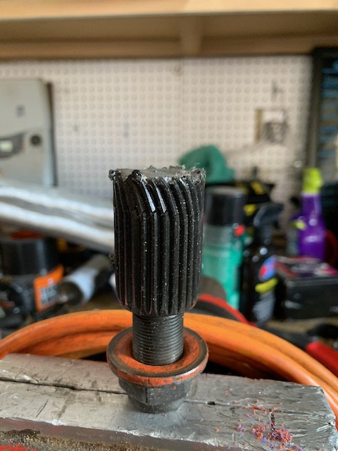

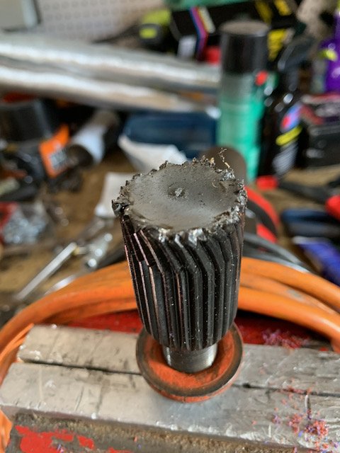

Not Much, but it's all I've got. 28 spline pinion shaft on a g-force 9" rear end. Five hundred more RPM than planned and didn't exactly roll into the launch. Well prepped track in Houston. Since replaced with a Mark Williams 35 spline pro gear third member. The difference in the pinion and pinion support areas is noticeable. Rebuilding the 28 spline for
a 1/2 mile and mile set with a 3.0 ring and pinion

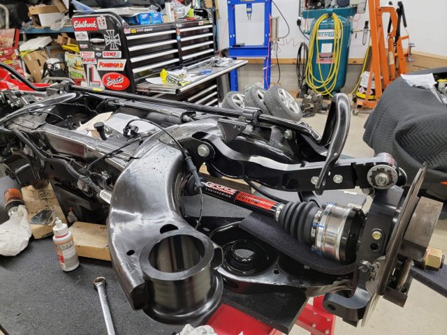

This is the best in my opinion, all MOPAR.
Factory 9.05512 dia. gears in Billet case.
Uses all OEM and aftermarket Driveshafts & Halfshafts.
Thanks AJ!! @Hemituner 20210420_124043.JPG 20210427_200458.JPG 20210427_200541.JPG 20210520_195926.JPG 20210520_195955.JPG

I am the owner of the Hellcat that talked to you while you were in the staging lanes to compliment you on the car at the MHSH at MIR. Well we took the diff out this week after winning the 10.0 index.

What's the price tag on that jewelry?
Your best bet would be to contact AJ at Hemituner Performance as I would not be able to tell you what the current cost is in case it changed from when I ordered it. You won't be sorry though. Great product, great person to deal with. Stands behind everything he does and sells.

That's a piece of Art. But for street driving, it probably should have some cooling fins.
I mostly drive my car on the street and have had no issues from excessive heat build up over the norm. A few things to keep in mind, none of the old school diffs or other aftermarket diffs available for our cars have cooling fins either, aluminum dissipates heat faster, we are now using synthetic gear oils compared to old school which are much better, plus you would create higher temps on the track then you would on the street. I am also changing the oil in the diff more often. If I do notice any issues along the way, then I can always install a diff cooler. But so far everything looks good.
