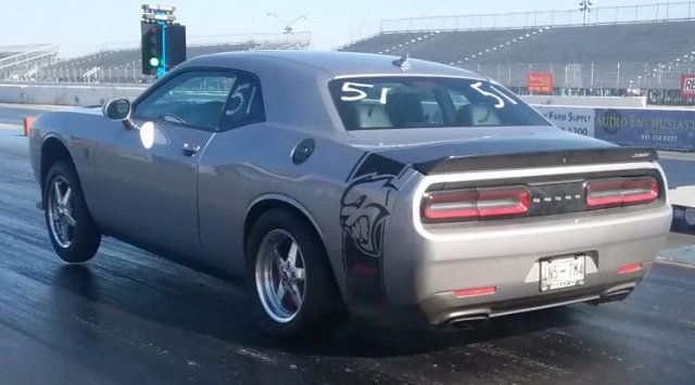

hellno
#1308
3,326
5,815
memphis
This is what results I get with Curt 1EAFE834-C067-4B71-94F9-D053657B2F78.jpeg

The curt dusteroff special
coolblue
#1172
1,577
2,695
She digs and boogies. You put Demon springs in? Remove sway bar?
hellno
#1308
3,326
5,815
memphis
I do have demon springs but my car is full weight other then the wheels nothing removed at all and I also have a bwoody 3.5 race cooler on the front bumper and that’s on my lowest power tune 3.10 pulley I haven’t been able to hook on track 2.65 pulley tune just too much power
Your def getting the power to the ground with current setup. So your best 9.92 was with the 3.10 and 10% lower? You haven't even gotten to unleash the 2.65 yet?
hellno
#1308
3,326
5,815
memphis
No that was before on a 2.85 upper and 10% lower on pump gas 17 psi
Now I have 3.10 upper 10% lower on ethanol 2lbs less boost but more power the car is faster now with less boost the 2.65 nets me 19-20 lbs of boost and still 21 degrees of timing at redline
