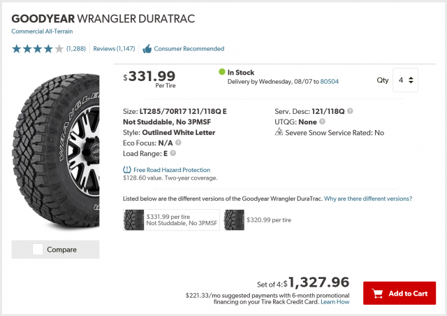

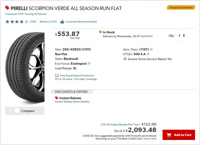

I just paid ~$330 for Goodyear Duratracs on the truck and was happy to do it after paying ~$550 for Pirelli tires on the DSRT, both within a month of each other.
However I don't swap either vehicle for winter, I just run the same tire all year.

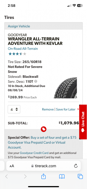

Just go on the Tire Rack website and search your vehicle and tire size to see all the different tires and prices. You can see what they have in regards to the cheaper ones. The tires will show photos and have ratings and reviews.
Yup, that's where I go to find out how tires compare.
For pickups and station wagons (aka SUVs these days) I usually don't even bother with ones that aren't 3-peak rated. And when I do, for the wagons, it's generally the Conti DWS06 that gets bought.
One thing worth mentioning, 2ndAmend, is that if you click on a tire, a bit down on the page you can then click on how they rate vs. others in the class. That's where I find out how they do on ice and snow.
Longevity etc. I don't give a crap about - my tires generally age out, not wear out. But I do care about price, which is why I got Continentals for the Durango and Firehawk Indy 500s for the 'Cat. Unlike BULL, I don't have the near unlimited funds it takes to buy Pirellis. And I don't like heavy run-flats even if they were half price.
