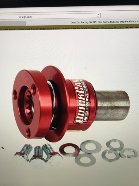

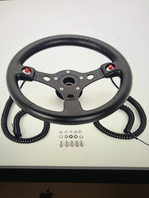

I want to replace my steering wheel with a quick release race setup. My wheel is locked in place due to the electric adjustable feature being disconnected because of my race seats. That means I have to squeeze by that thing getting in and out when the door bars are in at the track. The quick release device has to be welded to the steering wheel shaft. Here’s the problem...... the so called “clock spring” thing with the turn signal and rest of the electrical stuff in there has the steering shaft going thru it. Anyone have enough experience in this area to offer some advice. I want to add one of these while retaining all that.... 🤪 9A821BAD-70DE-4453-B564-BAEE8383E739.jpeg E05A24F7-940C-49E7-9115-9CB52A45E30F.jpeg

Red buttons.. forget the signals.. go nitrous and ejector seat lol!

Well above my pay grade..

That’s what I’m hoping. I went on the website and they have like a hundred variations. Nice stuff. Too late today to talk to anybody so I’ll do that tomorrow. This looks like the perfect solution. Thanks.., I appreciate it!
No problem hope it works out for you.

I do occasionally drive it on the street for car related stuff or if I feel like rumbling around town. I have race seats (no airbags with those) and have full harness for both front seats. Those are used all the time. I did a lot of looking at all the hardware online last night and it says they do not offer a “hub adapter” for the Challenger. Every POS import ever made, but not American. I will call and talk to somebody about my options today.
