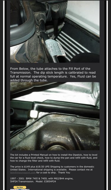

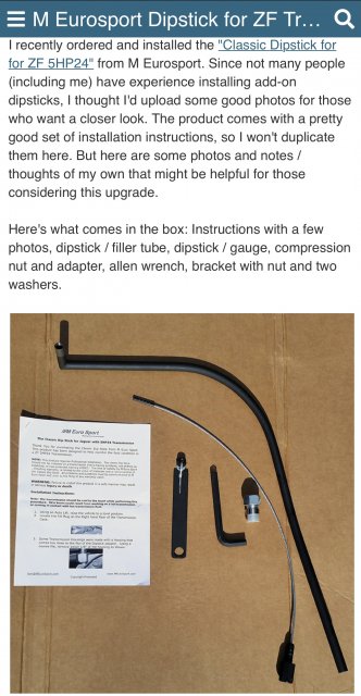

Fun fact, a company makes an aftermarket dipstick for the ZF in the bmw (also no factory dispstick) It’s just a tube that screws into the plug and goes up to the firewall. Someone needs to make the same thing for these.

I’ll take one please for whoever wants to make one. For as cheap as this one because it’s the same freaking thing.
