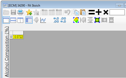

Figured this was worth breaking out to a new thread for discussion. @jonx96 @Hpindy @16GoManGoHC2
The stoich point is programmable in the Hellcat. Factory is .0722. Divide it by 1 to get AFR of 13.85 that is close to what is displayed on the dash. Mine usually reads like 13.5ish on pump 93 at idle and cruise. PE is power enrichment and there's a separate table that is an adder for when WOT is achieved. That's how you get the WOT fueling where you want. Factory PE table is .0110 which is 12.02 AFR, but they rely on COT (catalytic converter over temp) which is yet another table with a fuel adder amount to come in pretty quick when the cats are calculated to be at a certain temperature (no actual sensor measuring temp) and you'll end up with a 10.5 or 10.8 or so AFR reading on the dash with pump gas when that happens.
To have the dash read the actual AFR on E85 the stoich point in the tune would need to be changed (with about a dozen other tables) to that of E85 as it has a different stoich point than gasoline. E85 is 9.85 (.1015). Straight gasoline stoich is 14.7 (.0683) and SRT chose 13.85 (.0722) for whatever reason. Most think that is to account for the ethanol in most pump gasoline these days. Locally mine says "up to 10% ethanol". Once you get in to flex fuel tuning, you actually have multiple stoich points in the tune to account for varying percentages of ethanol and that gets pretty complex with alcohol multipliers for PE as well as other things like cold start, etc.
Do you have to change the stoich point in the tune to make the dash read correctly, no. Is it the right way to do it? I think so as I believe that is how the factory would have done it if they put the car out to run on E85. Cars will run just fine without making that change though, as long as the injector data is setup properly for the fuel being used, like around 25-30% more on the fuel mass for E85. I prefer to know what tune and fuel are in the car and making this change allows me to take a quick look at the dash and know. If I see 9.8x at idle I know I'm on E85, 13.x I'm on gasoline. My flex fuel tune works the exact same way E40 is around low 11, E60 low 10, full E85 9.8.
All of that is talking AFR. If you're staying with a single fuel and know the stoich point and it never changes then dealing in AFR is fine. I did for YEARS on my old car. Once you start changing fuels with different stoich points it can get confusing so Lambda is a simpler way to think of it. Stoich for any fuel is Lambda 1. More than 1 is lean less than 1 is rich. HPTuners can read the wide bands in Lambda as well as some AFR settings for different fuels like gasoline, ethanol, LPG, etc, but you can't create a custom one like the Hellcat would need (13.85). Using Lambda is the easiest. For gasoline a Lambda of .82 - .83 is what I target for PE (WOT). .82 x 13.85 = 11.35 AFR. On E85 I target .81 Lambda at WOT .81 x 9.85 = 7.97. At WOT on my E85 tune my AFR gauge reads 7.97. Cruising around and idling Lambda will, or should, be very close to 1.

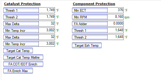

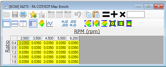

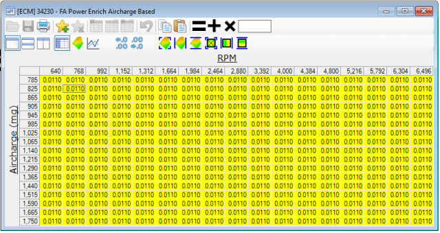

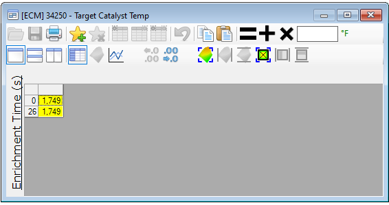

Here are a few screen shots from a 2020 Redeye factory tune file thanks to @DRAGRCR for sending it to me.

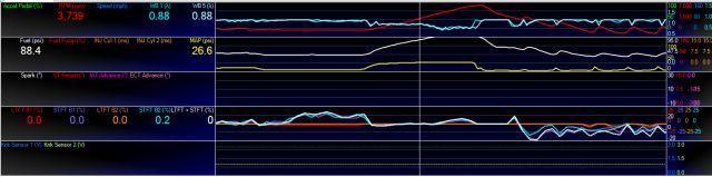

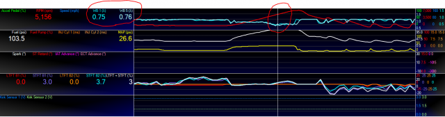

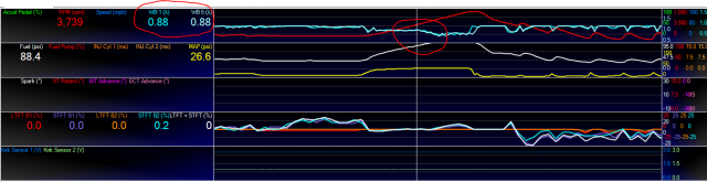

Finally, here's a stock Hellcat on the dyno. You can see where the Lambda starts off around .88 (12.1 AFR) and then suddenly drops to .75 Lambda (10.3 AFR) as cat over temp protection kicked in. That's a bit overkill on the fueling during COT in most tuner's opinions so that feature is usually disabled in a custom tune (mine included).

I've been trying to think what to type that you didn't cover above so for now I'm going to help break down somethings that helped me learn this part of the Hellcat tune.
The PE (Power Enrichment) table using either Aircharge vs RPM or PRatio vs RPM. Which is added by the stoich value. (Does anyone know why the Aircharge and Pratio are different?)
Breaking down stoich and power enrichment
.0722 Gasoline Stoich | .0110 =Aircharge vs RPM PE table
So
.0722+.0110=.0832
1.0/.0832=12.02
To find commanded you take 12.02/13.85=.87 Remember the 13.85 comes from 1.0/.0722=13.85

Yep, you got it. One thing, you say to find "commanded" but what you're really showing is the Lambda value. It shows in HPTuners as commanded though, so I know what you're saying. If you're logging the right pids you can even see what the PE adder value is. The PID on my 2016 for that is "FA Enrichment".
The Hellcat isn't "supposed" to use VE. I put that in quotes because I have found a few random tables where apparently you can impact fueling with VE, but the tables are either mislabeled in HPTuners, or they do odd stuff I don't fully understand. I've mainly used these to correct areas where idle and cruise trims are different but use the same injector pulse width.
My 2016 has NN (neural network) enabled. This was introduced in the 2009 VVT motors to the best of my knowledge and tuners had fits with it back then. I had one of the first VVT motors that was supercharged and tuned and it was a challenge for the first year or two. AJ (Hemituner) tuned that car back then. If a car uses NN then supposedly it does not use VE (volumetric efficiency) but like I said, in some places it definitely does, just not for primary fueling at least on my Hellcat.
I don't know why aircharge and p-ratio have different values for power enrichment fueling. Maybe the table scaling is different enough to warrant that, but there is a drop down where you have to pick one or the other and Hellcats use aircharge. Because of that, I just copied my aircharge PE table values over to the p-ratio table, but it really wouldn't ever use them anyway.
