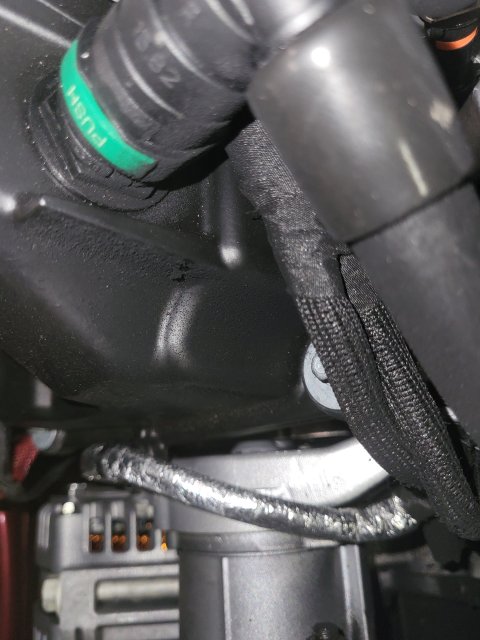

None of those photos show the wear indicator
See the last photo,that is the tensioner.It appears loose not in the middle.

The tensioner has a range of movement and theres a marker. That marker should be close to center of the range. That's what I'm asking about. I don't see it in your pics.
The tensioner on the 22 Redeye is a different design.If you look at my first post. There are 5 photos, the tensioner is the last photo down.It does appear loose. It is not in the middle.Below photo shows the top of tensioner where the marker would be on the previous tensioners.
