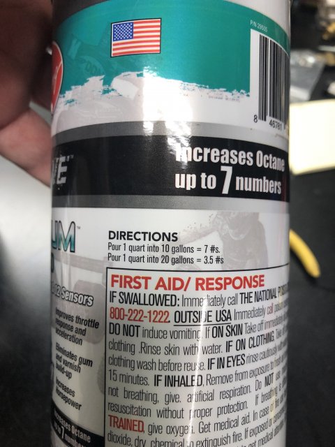

Go to Advance Auto and get yourself a qt of this and dump it in the tank, drive it for 10 miles of so to get it to the injectors and do a hit and see if it still smokes. If possible have your son data log before and after.
