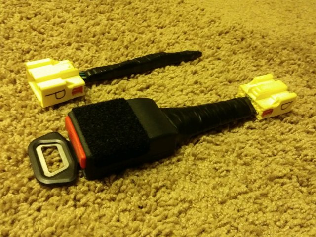

I took the info that Pete posted in the other forum and info I learned from members buying full on Hellcat Harnesses for me to cut apart and learn from, and now I can now make bypass harnesses for 2015 - 2019 both Pass and Drivers side. I am now making them with all resistors. No seat belt buckle needed anymore. So, they are cheaper to build and more compact. I also make the Windshield Washer Bottle level foolers if someone wants one of those. All this does is make the AirBag light in the dash go out. So, if you are like me and do not like warning lights on. The main reason I got involved in this is because you may not pass Tech at some tracks with your AirBag light on and my Friends and Forum Members were asking me to make them. My local track, Irwindale, will not let you race with the AirBag light on.

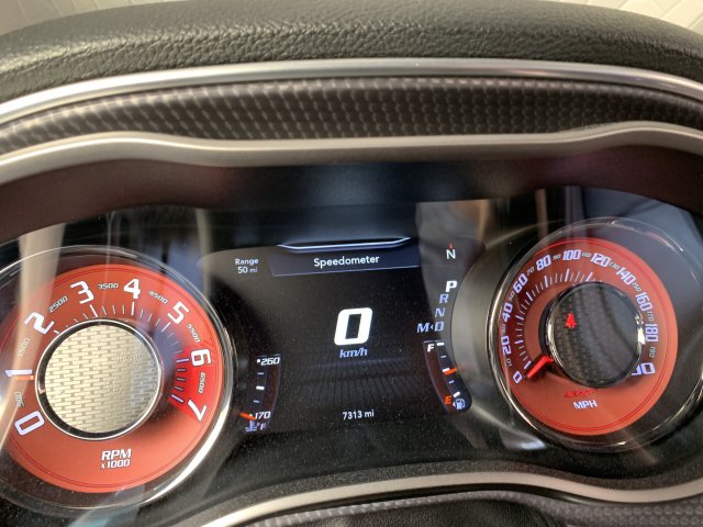

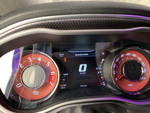

Ok I think I have one of the first sets of bypass harness‘ made by Ron for the 15/16. I tested both my 15 HC Charger and 16 HC Challenger in the same manner.
step 1. Start the car with everything connected in factory settings. Allowed the airbag to self test and light went out
Step 2. Unplug both factory harness from the seat and start the cars. I let them run for a bit
Step 3. Plug in both bypass harness’ start the car and let run for awhile. Airbag went out in normal time.

why is seatbelt light on in pic 3 ? …..does it stay on with bypass plug ?

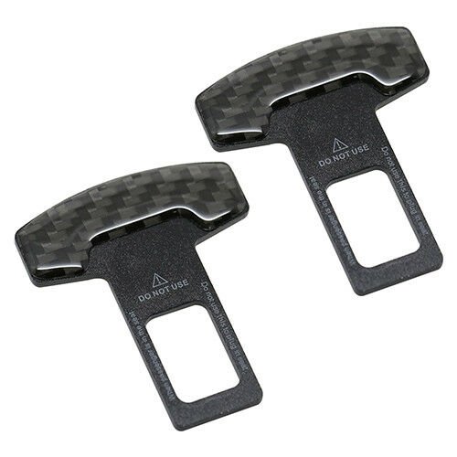

I only said it will turn off the airbag light. But if you want the seat belt light to remain off then it will require a redundant seat belt buckle that would add substantial cost or the harnesses can be made so you can unbolt your OEM buckle off your seat and use that for no extra charge.
This is the redundant buckle version. I am pretty sure you would have to plug in a clasp into the drivers side to eliminate the seat belt light. They can be bought on E-Bay to eliminate the chime.... RITTER.jpg s-l640.jpg
I didn’t have my (drivers) seatbelt fastened. When I fastened it the light goes out.
