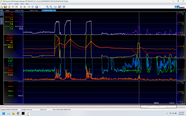

So if someone has .02 cents they'd like to share I'm all ears. Today once again after a pull, cylinder 8 said bye bye. Pulled over, shut the car off, turned it back on and it came right back. There are no mechanical issues with the cylinder at all. The PCM is doing something it shouldn't be doing and I don't know how to stop it.
Here is a screenshot of the logs.
They are also attached as a log. In the tune I have turned of everything I can think of.

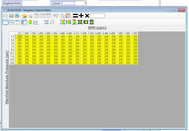

[ECM] 39209 - Weighted Catalyst Misfire: Weighted Catalyst Misfire vs RPM vs MAP. - I maxed out these values, HP Tuners will not let me go any higher. This could be a cause, I managed more than 255 misfires while fucking around and well here I am.
This table is a clusterfuck. Even with parameter access I still can't edit it, maybe a bug in HP Tuners? This could be interfering but my hands are tied. Also updated today to 5.1.1220 beta and it is not editable still. I'll reach out to HP Tuners on this one, also reached out on the @ostmike thread to see if he can edit this able. @Jon-MooredPerformanceLLC can you edit this table?

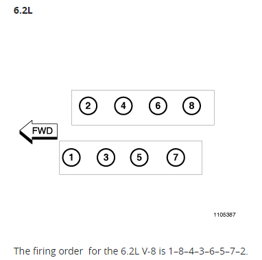

I have no idea wtf this is for. I know the hellcat firing order is:

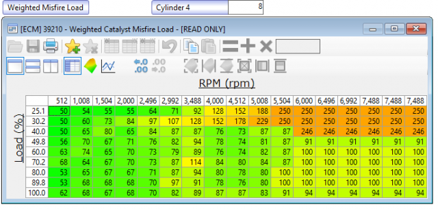

These are intimately linked but I haven't figured it out, can someone explain this?

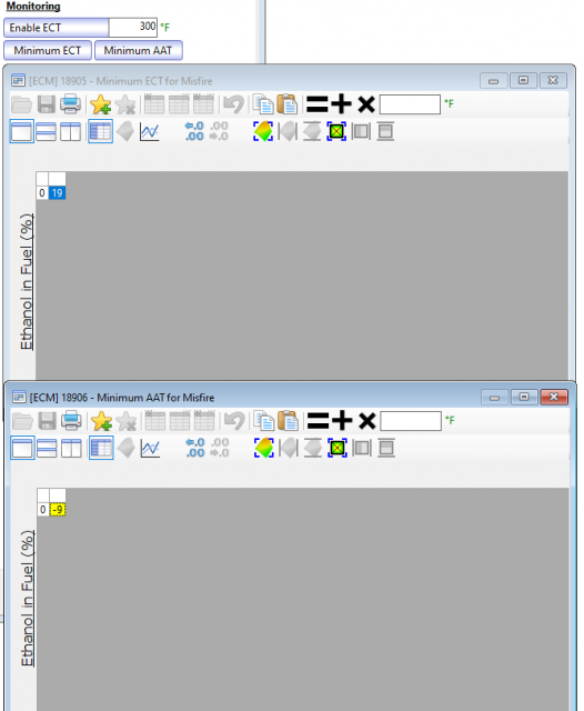

Raised temps to 300F, definitely not seeing this temperature. For some reason the labels in the table are not correct, wonder if this is an issue.

I bet you had a "compare" tune opened and then closed it while viewing this table marked "Read Only".
Exit VCMeditor and then open only the tune you want to edit. Do not open a compare file. I have had this same issue happen on other tables that are normally editable and the above was what I had to do.
