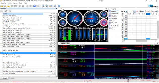

Are most desensitizing knock sensors on these cars? I see a fair amount of STKR on take off with a 2.85 and e85 using stock timing down low. Ramping it in up top I get no STKR. I feel I should be able to add 5 to 7 deg down low without getting any STKR.
I'm thinking I'm going desensitize a little to a little bit in the ranges I am seeing the KR.

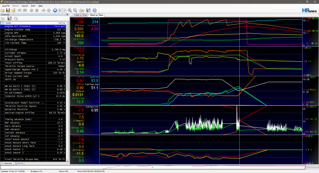

Most of that is probably noise. 4500 to 5500 they will show false knock.

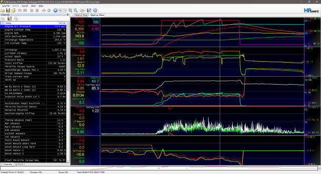

Also with the knock you saw on e85 were you getting smoke out of The exhaust at any point? Or did you have any other symptoms besides knock in the logs?
Also in this log it looks like knock sensor 2 is the one that spiked.
I’m not sure about other logs. But looking at a chart of placement it’d be my guess that would be the one that picked out the most blower noise.
But cylinder 7 is also on that side.
When I experienced knock at the track on gasoline yes puffs of grey smoke when it would do it. Don’t know on corn as I didn’t have a camera to mount back there to look for it. Right now I’m in start up tuning of rebuilt engine and I won’t desensitize the knock sensors or use octane booster in gasoline any longer based on what I saw during tear down. Only real symptom in the logs where knock, my 1/4 MPH hit 142 in cold air negative DA. Something I wondered about is I was condensing alcohol in my UPR catch can when it was in the 30’s back in November, from blow by, I bet that does not happen this year when it gets cold out as now I have little to no blow by. I’ll look for those knock screen shots during lunch break today. Plugs 1, 3, 5, and 7 are easy to get out, I’d look at them all and leak down test while your at it, it’s the only way to really know. You could also borescope the cylinders. BDC and look for missing piston material in the valve relief areas if you don’t have a compressor to do a leak down test but it’s very hard to see and not really conclusive info.
