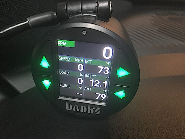

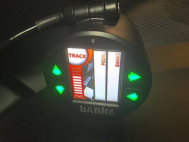

My friend reports improved "stock" transmission operation since using the Pedal Monster. TCM adaptive learning? I suspect that the computer thinks he's driving it harder than he actually is, then adapts to that routine. He wasn't comfortable with bluetooth control over the accelerator, so he opted for the Super Gauge controller.
