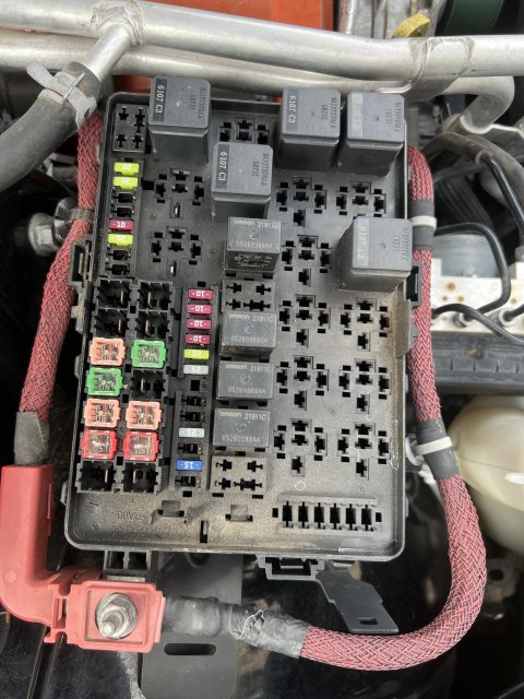

My car is overheating out of the overfill canister. Had a lot of work done. Fan is not coming on. Even with ac. Looks connected. Where is the fuse for this? Can someone show me a picture? How much is a fan assembly if it went bad?

FAN FUSES ARE IN ENGINE COMPARTMENT FUSE BOX ON PASSENGERSIDE RIGHT BEHIND THE HEAD LIGHT

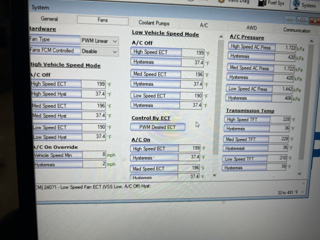

So just a thought here. Your car was retuned is it possible the tables were set to Celsius and they put Fahrenheit numbers in?

Thanks. Go to system, fans and look for?

Just looked. Farenheight
Ok and the numbers make sense right? Because I could write a tune in C and then you could open it and it would convert to F

Pwm linear is on. Fan fcm disabled.

I will try taking a picture.

160’degree thermostat. Pwm desired ext set to 163

How about the fan relay(s)? I used to jumper one of them so I can keep the fans running in the staging lanes with the engine off. At least try jumping it to check if they turn on. Just a simple wire with male spade plugs on each end. Then you know if the relay is bad. At least this worked in the older LX's. I haven't looked if the relays are still the same now Maybe @Diboblo can help.

Great idea. Single fan, Hellcat, uses an inline dropping resistor for slow speed fan ops. For high speed ops, it's full 12v. There are 2 fuses 3 and 19, in the front power distribution block, as well as 2 relays (hs and ls).
All can be checked, in a few minutes, except for the dropping resistor.
If you have AlfaOBD, you can ping the fan and check relay ops and fan ops.
Sometimes, with those 50 amp box fuses, it's easier just to replace them.
Lastly, no harm in removing the relays and wiggling them, in the socket. Oxidation can cause havoc, depending on how humid your area is, or has been.

Am I missing any fuses or relays?

They look all there compared to pictures on the net. The 50 amp ones look like toast.
