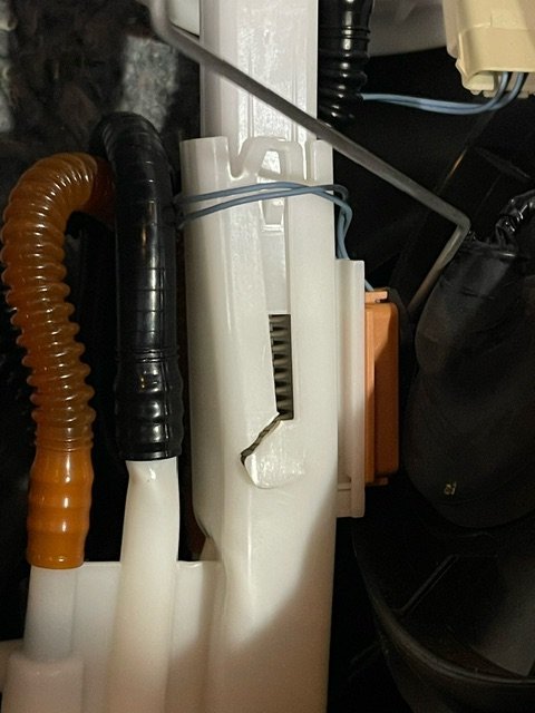

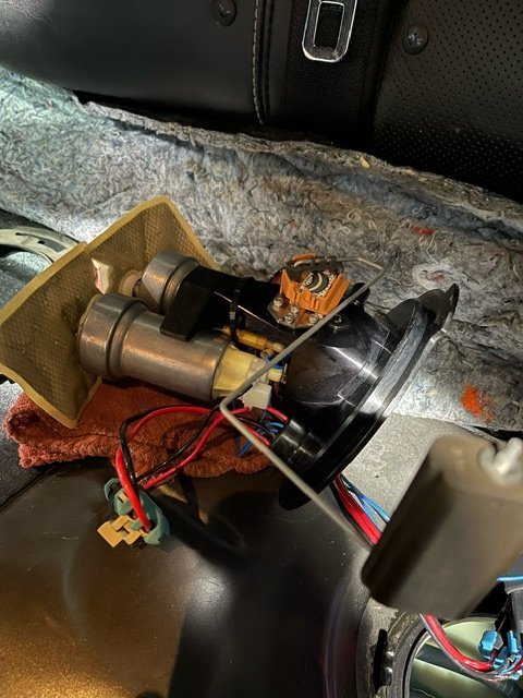

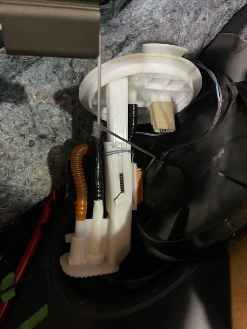

photos
fubar569
#1073
1,177
1,656
Bradford
Is that jet pump housing actually cracked? Literally HOW.
But...the cracked housing aside...which yes. Is expensive unfortunately...
Those orange cards and float arms? Dirt cheap. Like I said. About 110-130 a pop. And they can easily be purchased separately.
even that jet pump housing assembly should be cheaper than 875...but ive never seen that happen before either so...

I wish I knew more about cars. I see the crack. I wonder if they cracked it?

Yep. 788 through tapped performance. So 875 or so is not unreasonable. I will never know who cracked it.

@fubar569 or anyone else post pics of how you zip tied them out of the way

How the hell did he get the pump out in one piece
They called me and asked permission to cut the wires. Does that answer your question as I know zilch on this stuff.

Not really, you have to lower the bottom part into the tank and then align the top lid, not drop o rings and the. Screw it in. So wondering how they got it out without taking the top hat off
5,572
4,610
I’ve never heard of the passenger Venturi pump breaking or going bad no reason to remove it for pump install. Looks like he broke it ripping it out in an angle to be honest
5,572
4,610
The twin pumps don’t actually deliver fuel to the engine. The passenger “pump” does. Driver side twin pumps trans fuel to the other side of the saddle tank

Thread Starter #18
If you look at it do you see that vertical scratch? Well they have me over the barrel. Can’t accuse them of breaking it.
Interesting. So basically the drivers side one keeps the pressure up in the passenger one.
