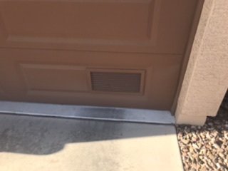

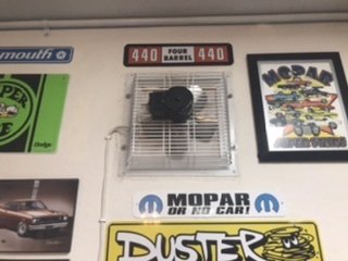

No question. An insulated door will be better than a non-insulated door. I have seen small screened louver’s installed in the bottom of a door. Maybe you could insulate it and use a floor fan to exhaust the hot air with those kind of louvers in the door...

Before the split level went in we tried the exhaust fan up high and the inlet vents down low on the garage doors. It was better but in the end we went with the split level.
Good luck.
