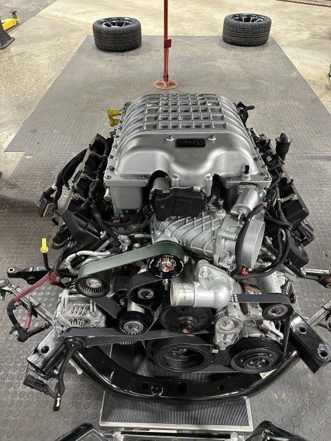

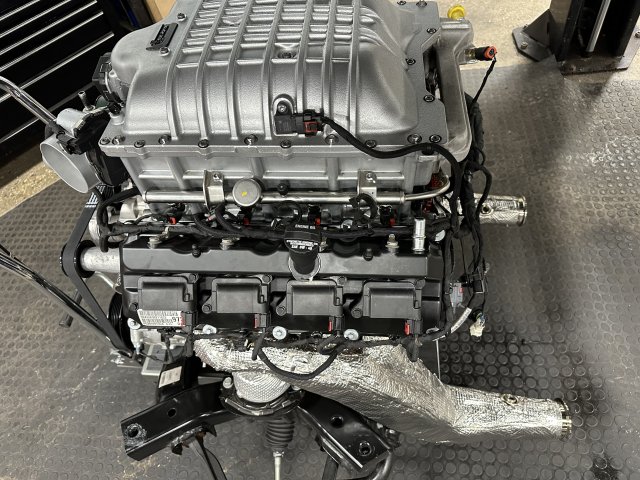

Car is back at the shop for rebuild. Should be mostly finished by Friday I'm told, so definitely pickup and tuning next week! Almost there.

Update is we're held up by the FI Interchiller install. New AC lines were required because this is a redeye and not a regular hellcat and we also ended up discussing a reservoir which needs to be sourced or fabricated, to get the most out of the system along with a pump. It sounds like fabricating may be the way we go and would keep the delay and cost to a minimum but we'll chat about that today. The lines will be here Friday and the pump will come quickly from FI since these guys are a dealer.
If the delay would be too long, I'll just have them throw the damn engine in it and get me on my way and I can come back in the spring for the interchiller install. Engine is ready to go and has been. They just want to use the space in the engine bay to make the install easier if possible.
