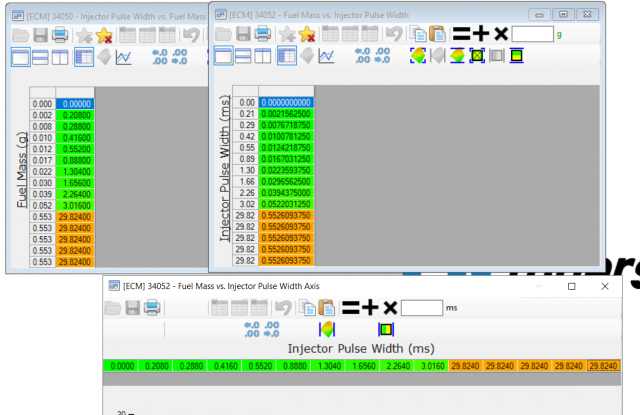

How I setup ID 1300XDS injectors for my tune.

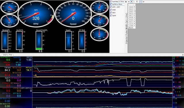

Since you are doing it your self I'd plan on getting those numbers a lot lower than 5 percent. This is just a log I have. I have dialed my injectors in even a little farther than this. This looks to be a pretty short drive here like really short. But you get the point
Take a look at this ST graph this is how I gauge how close I really am.

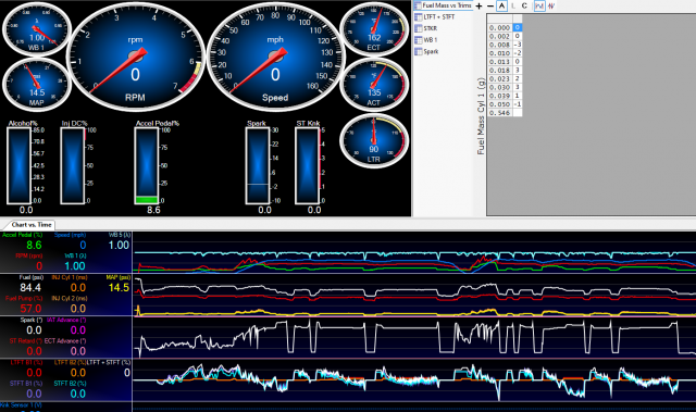

Also I am done messing with these things. I kept over shooting and it would run lean, then I would adjust and it would run rich. I am erring on the side of caution. Went for a 20 minute ride and did some normal town traffic and then got on the highway around 75mph. This is what I'm running with and not touching it again unless I get some serious lean spots for just general cruising. Would rather be richer than on the side of lean. Next stop, WOT tuning.
It's also only 30* F so I'm probably going to be running stupid rich in warmer weather. Hopefully I will have temps close with a killer chiller.

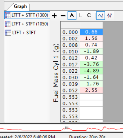

Well, you guys motivated me to dial the injectors in tighter. Thanks for the tip on the histogram setup, made it super easy.
I don't think I can get much closer than this. This is from a 15 minute drive and the values are an average for the entire log so dang close.

Here's what the INJ PW histogram looks like for those that are interested. This sorta makes more sense to me as you're manipulating how much fuel mass is injected at a specific pulse width on the injector.
