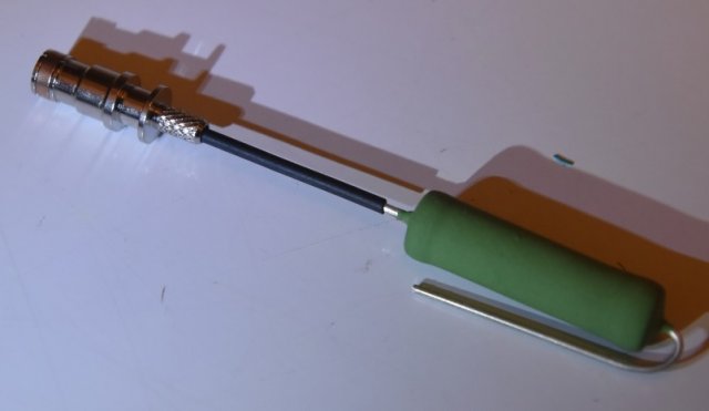

How did you end up at the 10K ohm, 7W (fixed) wirewound resistor calculation?
Reason I ask, this will work fine for the purple (FAKRA D) connector, however, per my earlier comments in this thread, *IF* I need to also block the pink (FAKRA H) connector, I'm not sure if the resistance would be the same, and not sure how to calculate.
Obviously would need a different plug housing also.
The pink is FAKRA H.
In the FSM, under cell troubleshooting, they call out for a specific miller tool, to load the cell module, once the antenna is removed. Simply unplugging the antenna is NOT recommended, as it can cause damage to the mode.
The Miller tool has a load of 10k ohms. You could use a much smaller resistor, but it is difficult to add the faraday material to a 2 watt resistor.
I went with a WW resistor, because I wanted a 1%, close tolerance load. There is a small +/- window that HAL9000 is looking for. Anything outside that range and you will throw a code.

This may be a silly question, but in your design, how do you keep the Faraday cloth (conductive) from shorting the resistor leads? Do you shrink the connector/resistor combo first, and then wrap with Faraday, then do a second heatshrink over the faraday wrap?
Or maybe coat the center lead in epoxy all the way to the resistor housing?

One lead, of the resistor, is soldered to the center contact of the connector. Once inserted into the connector body, I backfill the cavity with epoxy. This prevents signal shorting.
The other lead is left bare, bent over the resistor and soldered to the shield, of the connector. Since shield is ground (in this case), there is no need to worry about the faraday material dead shorting.
I think I covered the epoxy business, in the first post. Either way, that's the way I do it.

Update:
Have crafted the blocker. Tested it with resistance meter, jacket-to-center-pin, reads ~10K as it should. No shorting. Faraday cloth has been wrapped several times around (5-10x thickness).
Installed said blocker on the FAKRA-d connector of the head unit, and oddly, I actually see an increase in 4G signal quality with the blocker installed, vs with the antenna completely disconnected.

First, quick walkthrough of my process for crafting @Diboblo's blocker. This is needed to explain why mine was acting like an antenna at first:
Found that sanding the resistor lead slightly and coating with flux allowed it to slip into the collar of the FAKRA connector's center pin. Solder can be done through the provided tiny hole in the pin if the solder itself is small enough in diameter.
Thin heatshrink used to protect the resistor lead.
Required a small piece of wire to reach from the resistor lead back to the casing. Wrapped/soldered this in place.
Attached other end of wire to plug housing. I also added a full heatshrink wrap of this assembly when finished [NOTE: had to remove this heatshrink later, explanation below.]
Faraday cloth wrap around interior heatshrink:
Finally, another heatshrink tube around the whole faraday cloth wrapped assembly, then attached plug housing:
Assembly tested at 10K ohms resistance, as noted above. When attached, the 4G reception improved (compared to no antenna) instead of dropping.
I created a test using a handheld RF spectrum analyzer, which shows frequencies and signal strengths in real time. I found (to my surprise) that if I wrapped the plastic antenna in Faraday cloth, there was virtually no change at all in signals received by the analyzer. If I allowed the wrapped Faraday cloth to touch the brass base of the antenna, it instantly dropped almost all signals to near zero.
Using this information, I then disassembled the cell blocker and removed the inner heatshrink that I had put in. Then I wrapped the resistor/wire assembly directly in the Faraday cloth, and put one heatshrink around all of it (the way @Diboblo described in the original guide). This ensured the copper cloth contacts the plug housing, exactly as it did around the base of the antenna in my test.
Finally, I reattached the reworked device. For a short time (~20 minutes), the 4G reception dropped to zero (no signal)! Unfortunately, then the system regained 4G reception, even with the blocker installed.
Removed the blocker, tested resistance - no shorts, still measures correctly. Ideas/input welcome as to why this seemed to only work temporarily.
