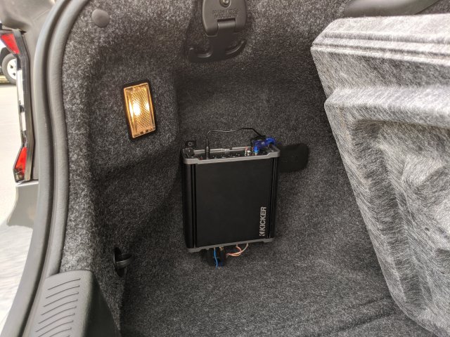

I LOVE the SKAR audio subs I bought. Still raging.
Bob
I can vouch for those Skar Subs, they sounded amazing when Bob showed me his setup. Here’s my setup. C709190F-D72A-4BD8-BB09-9A65FBC4583F.jpeg 8337568E-480F-433C-83B7-748B95BBF796.jpeg
