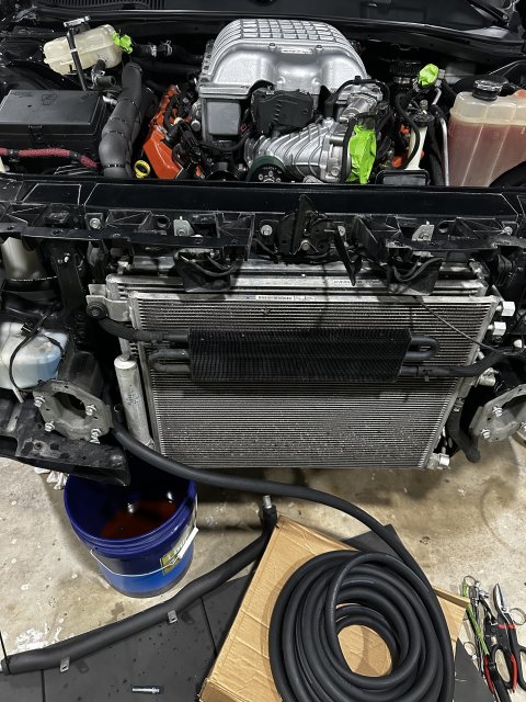

Hose came in. Decided heat exchanger is getting plugged off completely. If I change my mind, I’ll have plenty of hose left lol. Keeping the bugs on the condenser, adds character

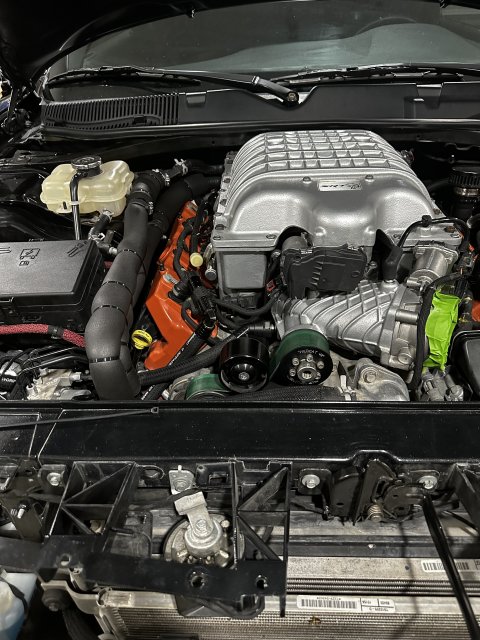

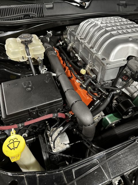

Thread Starter #44
Insulated good enough I’d say

Are you guys wrapping (insulating) all of your lines (too hot line included) or just the bottom cold line going into the supercharger?
I insulated everything including the pump housing.

Oh wow. Do you know what the stuff is they use to cover the chillers/aux tanks? They’re rubber insulation in sheets? Looking for some of that

I also used the more expensive wrap which is smaller in diameter and bends/molds easy
McMaster Carr has adhesive backed foam insulation sheets, I used the 1/2” thick stuff
