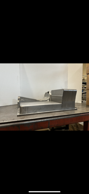

I have been working with Milodon over the last month to develop a front sump oil pan for the 6.2 platform that will fix the oil pressure drop on the hit for the guys racing their cars/suvs. We tested the oil pan this past weekend and it worked great. No oil pressure loss from the hit through the complete 1/4 mile run and we had very little oil residue in the catch can. This pan kit will also include a windage tray that helps keep the oil from accumulating in the top end of the engine and allows it to flow back to the bottom of the pan, this will help keep the catch cans from filling up with oil. This oil pan kit has trap doors in the front sump to keep the oil contained around the pick-up and does not allow it to run to the back of the pan and cause drag on the crankshaft. They will hold 7qts of oil plus the how every much the filter holds and will use the stock dipstick.
There are trap doors in the sides of the front sump also so the pan can be used for road racing applications. IMG_8928.jpeg

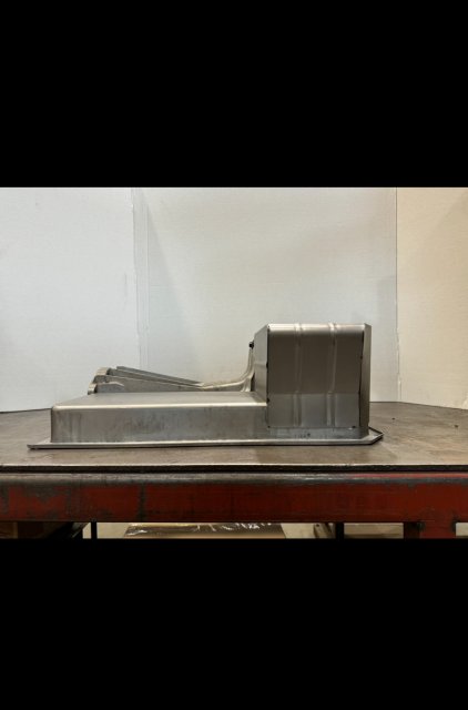

Do they hang down lower?

It does, but not much, front sump is wider. Here are a couple pictures during the build process compared to the stock pan. IMG_9019.jpeg IMG_9018.png

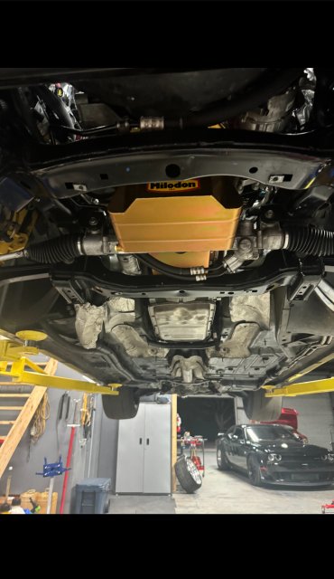

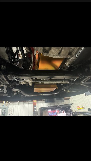

would also like to see a pic of it installed on the car if possible. Please tell me the pickup can come off easily without having to snake through the windshield trey. Huge draw back with the stock one

Let me see if I can get one of it next to a stock pan from the front. I am headed to Las Vegas for MATS today so it may be next week before I can get you a picture of it. I will get you some pictures of it on the car.
Pickup only goes through the windage tray on the sump end so that is not a big deal on installing it.

For some reason we did not get any pictures of it on the car. Demonology has a video dropping soon from the install. We are out in Las Vegas at MATS and when we get back to Texas and the car back on the lift I will take some and post them up.
