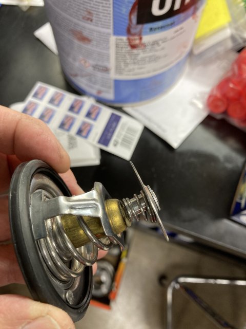

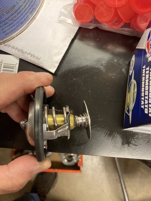

I’ve had 3 Misimoto’s fail, stuck closed, I wont use them any more.
3,323
7,860
Every failed one looked exactly the same, piston blew out and cocked to one side and it’s guts oozed out not letting it open.

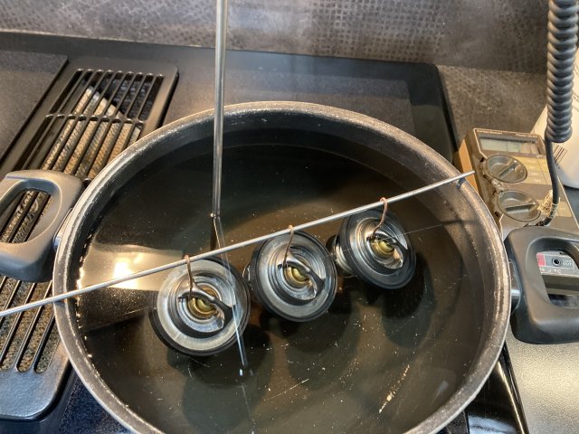

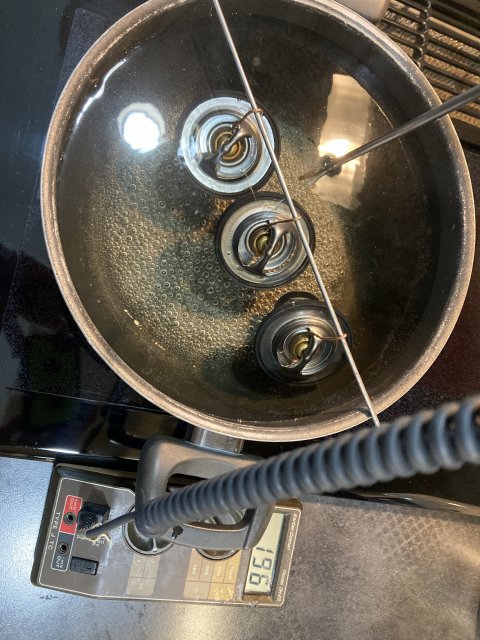

The one that opened and closed most consistently around 180, purchased from 3 different stores as 3 different brand boxes but all motorads inside each 471AC238-8BD7-4E3B-BF6C-B72AEB41B612.jpeg 7580B40E-85EC-4513-B9B6-B7DAB53E07C8.jpeg 4B04F0AB-403E-472F-A6CA-93D7431A8D92.jpeg box, all around 10$ each. I always test T stats before use, I bring them up to temp very slow and watch which one cracks first, get fully open first, and closes correctly then make a pick and return the others for refund lol.

These all have the little valve to be placed at 12 o’clock high. I don’t remember which store this one came from NAPA AutoZone or advanced auto but like I said they all three were Motorad hard to tell one from the other so it’s hard to tell which one went back in which box and went back to which store lol But again, all where 180 Motorads
