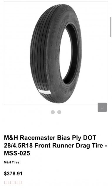

Apparently, m&h has a front skinny that “a lot” of people are running, but they don’t provide a load rating if to anyone. I run the ET Street Fronts, which are super light, 32 lbs with wheel. But I’m over the weight limit on them

And $390 for the 18” (28x6). Insane the price jumps so much

That was the main reason I didn’t get them, besides the weight. Too much money. If you take a good amount of weight out of your challenger you can be within the weight limits of the et street fronts

I got them incase I was on the street, it started raining and they would hold up to highway use.
I won't mix radial and bias tires.

The ET street fronts are radial (I didn’t post a pic). I really know nothing about the m&h tires, but people run them (probably just at the track). I drove with et street r and et street fronts to the track. No worries. But got caught in rain twice. Bad time
