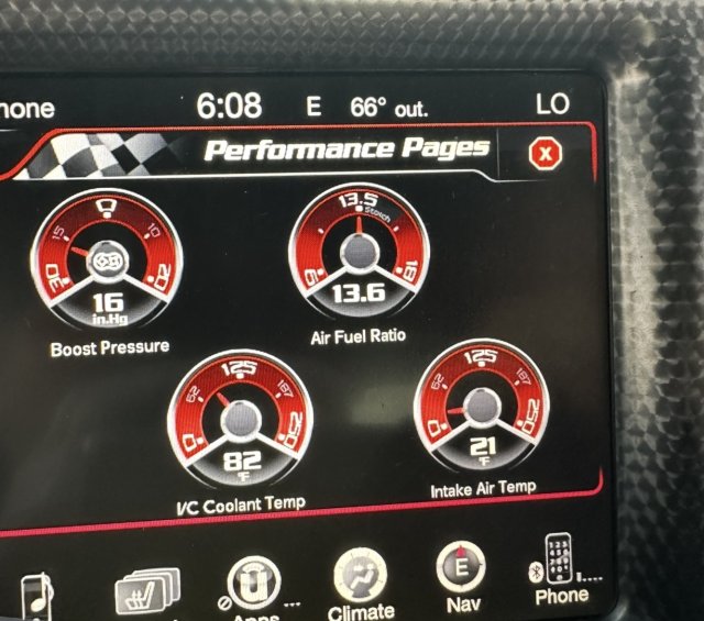

And unless my boost calculation is wrong (not sure if it will calculate correctly with 2 bar sensors) I was only making 17.75 lbs of boost
what pulleys and rpm were you shifting at to figure out about what boost you were at. You need 3 bar map sensors for what you are doing

Thread Starter #24
Just a 2.50 upper only, shifting around 6500 or so

At the track long tube headers with zero restriction

https://www.chargerhellcat.org/threads/2-4-supercharger-pulley-size-boost-calculation.14382/
2nd post by fubar is the same as yours. I would have guessed around 20-21 with headers
Very similar, but I don't know what the specs are in the headers he's running. He said 19 after the headers (which makes sense, you lose boost with long tubes), mine was close to 18 - so not far off. Mine are the 2" primary kooks with no back pressure in race form at the track. I did also get the max effort kong snout/bearing plate port and race bearing rebuild. MAT never got to 140
