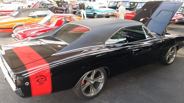

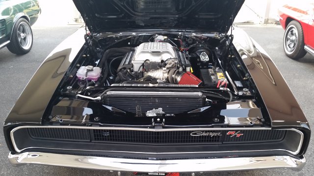

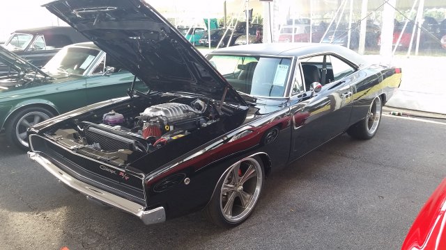

I was in FL for biz this week and stopped by Mecum. This car got my attention for sure - done nicely. It hammered today for $150K ($165K with buyers premium).
Good luck with building your 68 Charger !! 20210115_093039.jpg 20210115_093047.jpg 20210115_093113.jpg 20210115_093126.jpg

Is that a 69 Camaro in the last picture, sitting next to the Charger? The one with the tunnel ram intake? If so, what's going on in the headlamp area there? Kinda hard to tell from the angle of the photo...
11,710
19,832
high rise intake manifold and double pumpers.... yum
