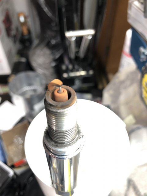

They run nice at 16 psi boost on pump 93 These were run with Torco, Boostane doesn’t make them as orange but burn as clean. ECA44438-C206-4C60-BCF4-FCC8A3116663.jpeg

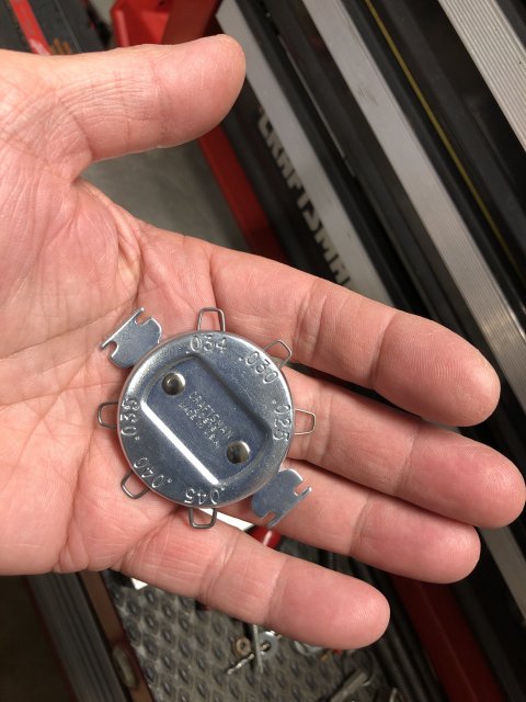

Can you recommend a good ground strap bending tool? Yes fragile and brittle. My setup is stated above. 955 hp, 1010 torque. About to add emp tank in trunk as that will add further cooling.

I use this Craftsman one, #40816
3,439
8,158
I use 2 together, one to hold and one to make the tweak with

I do not know. After 7k miles or so there is always a ton of black carbon on them.

I bought a adjuster. Pretty cool. 14 mm. You screw in the plug. Then on the other end you slowly tighten a smidge at a time until the ground strap touches the feeler gauge. With me I am going to take the extra step by not compressing it with the feeler gauge in it.
Was the car breaking up under WOT? Or are you just assuming they are fouled from color

Thread Starter #20
