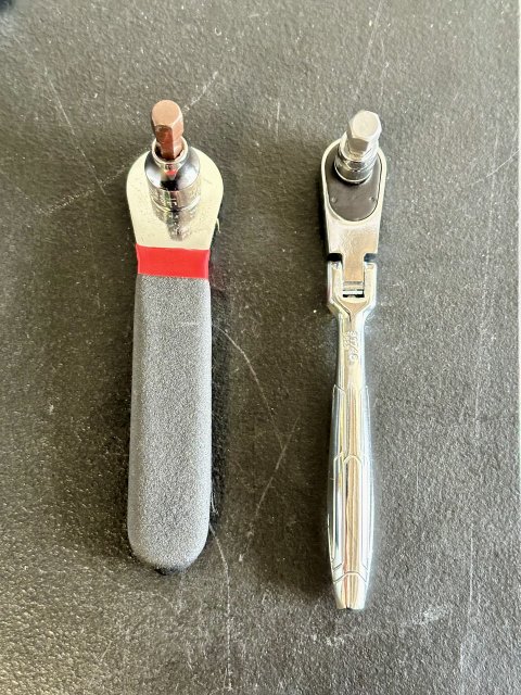

Here is what I used to access the fill plug. There is only about 2.25” of clearance, so a small tool was required. The 3/8” Powerbuilt low profile socket lever (non-rachet) provided just enough room to loosen the nut. Attached to the lever was a 1/4” socket with an 8mm bit. I also had a small 1/4” ratchet plus 8mm hex bit for faster removal and tightening. Both are about 2” in width.
The low profile lever is quite short, so I added a small cheater bar to the end…made it much easier to loosen the fill plug.
Unfortunately, there is no room for a torque wrench, so I could not torque the fill plug to spec. Another option for those who prefer not to remove the DIRS.
