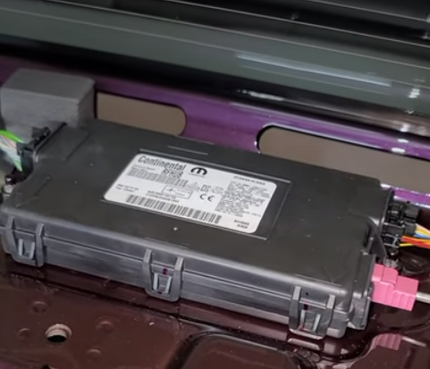

The RF Hub is on the back window sill as shown in the below picture. Seems to me, a thief could just cut through that flimsy fabric covering it, and plug in a new one, flash it and be on their way. Maybe it takes significant time to flash, or . . . ?
This is why I'm not counting on 1 security measure. Given time, a thief is going to get your car, but you just want to move them out of their comfort zone for how long it's taking to get away.

Just so we aren't confusing cutting a RF Hub out vs. uninstalling and reinstalling one properly since some might be misled - cutting one out is easy. Replacing one because you had the dealer lockout performed and then lost your keyfob requires removing quite a bit of the interior, replacing the hub then reinstalling the interior. Watch Speedy's video on installing a rear seat delete and you will see what is involved in doing it properly.

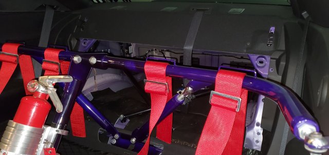

Totally agree. OTOH here is my back seat area. 😉 Try and get through that harness bar to get that RF Hub out - better be skinny and short.
