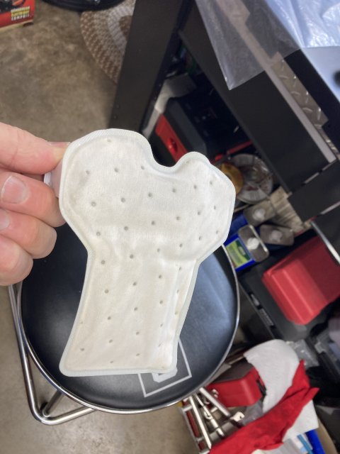

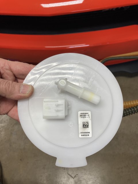

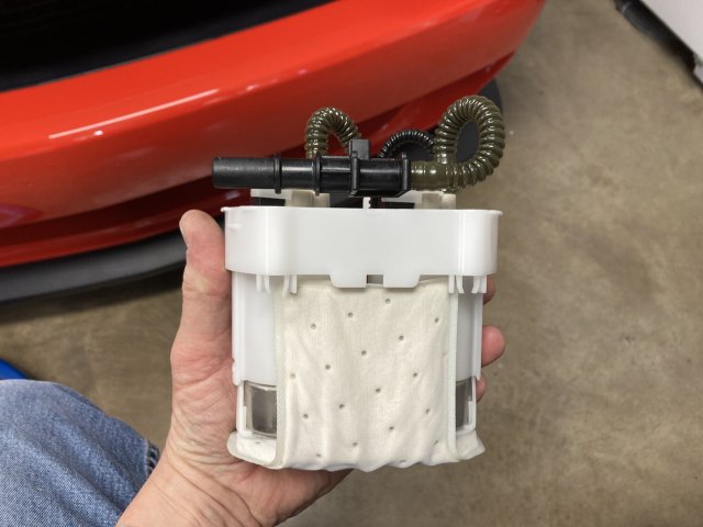

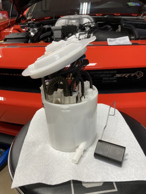

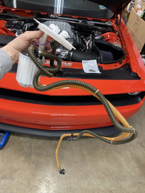

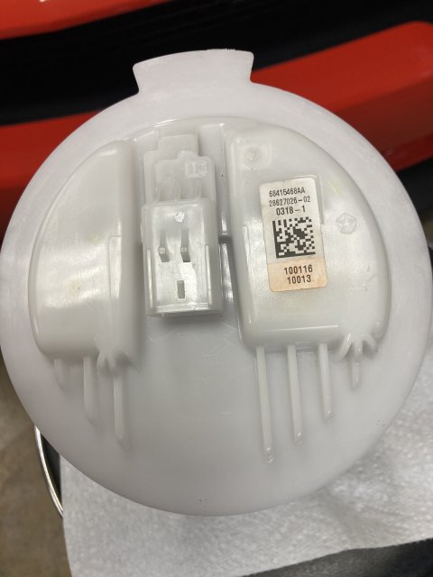

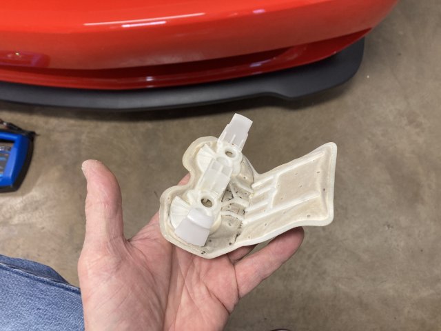

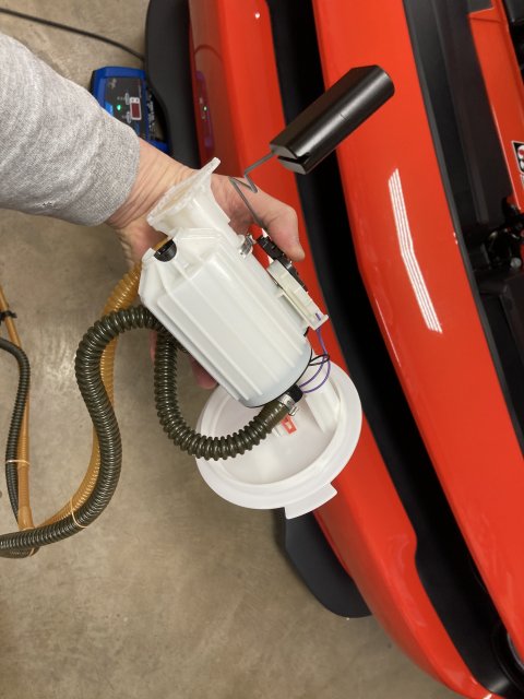

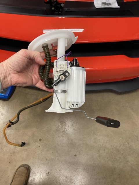

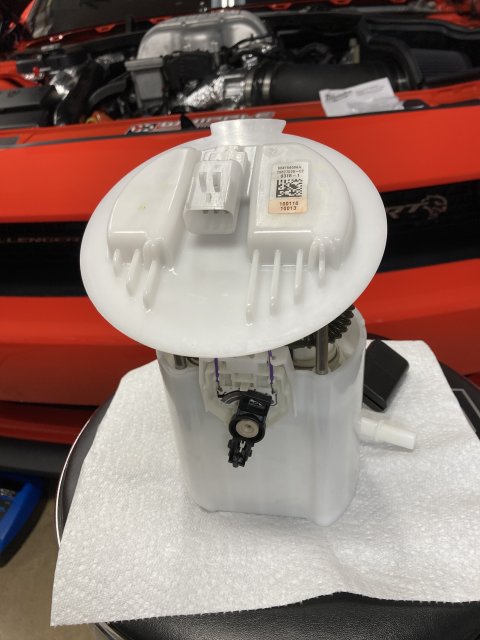

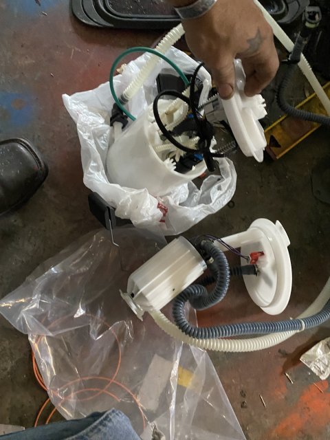

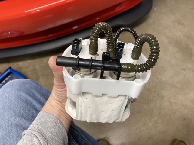

@jonx96 , have you pulled your pumps out yet? If no, check the passenger side pump bung and see how many wires are coming out of it. A 2018-19 RE system I had only had a fuel level sending unit on the passenger side, no pump what so ever over there. An item that looked like it could house something but it was just an empty shell that is connected to the twin pump system on the DS which looks like it pumps fuel over to that side not suck from it. I found it to be weird to understand how it works. I always thought there was a transfer pump on the passenger side but not on this system there wasn’t.

Yeah I'm curious why the RE needs the jet pump to go to an aftermarket system like the dual/triple drop ins. Interesting if the RE doesn't have a jet pump at all on the passenger side. I always thought that was required for fuel to flow.
3,322
7,852

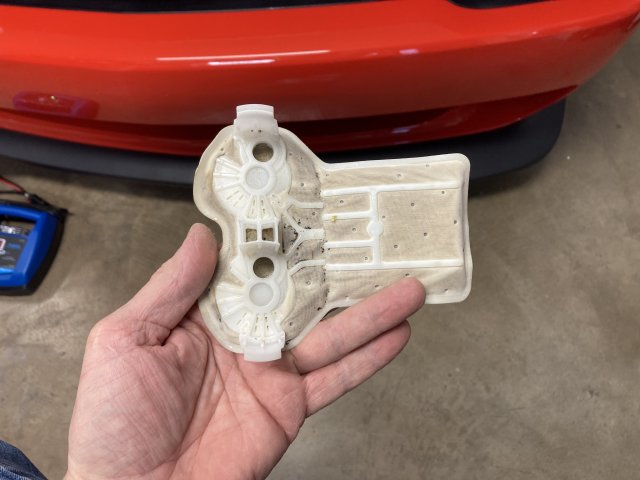

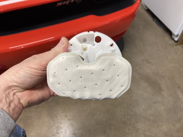

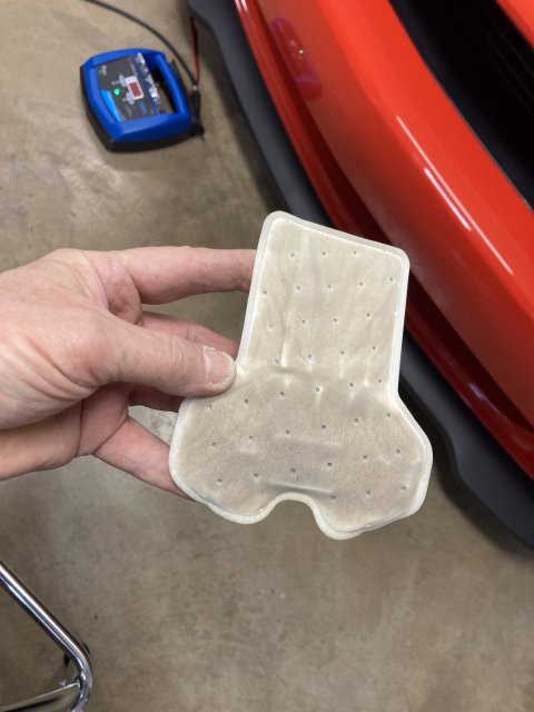

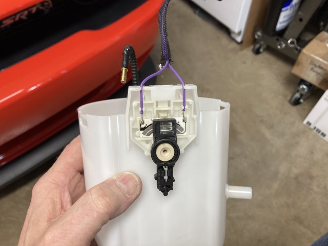

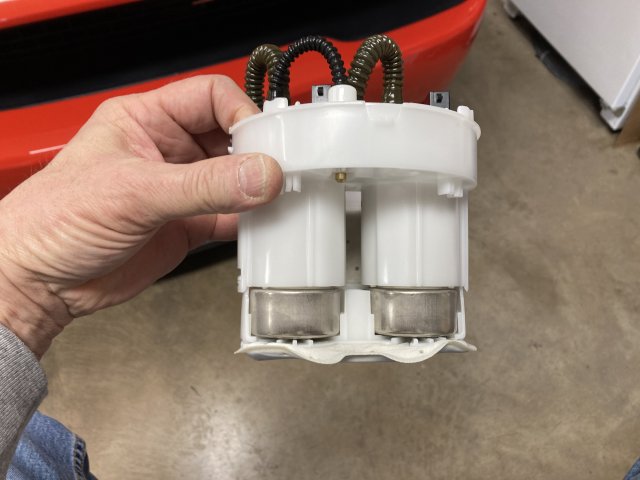

There was no pump on the PS on this Redeyes system. When I took the main pump system apart to clean it and replace the filter it looks to have on one of the pumps a orfice that sucks fuel from that assembly on the PS and the other pump a orfice to return fuel to that side so I think it’s using the dual pumps to push and pull fuel from the PS of the tank. These check valves had fine screens in them that were fouled with lint and debris. Guy probably didn’t need new pumps, just needed to clean the existing filters and screens on his system!!
I know how to do this now and can offer a pump maintenance service if anyone is interested let me know. $100 plus shipping.

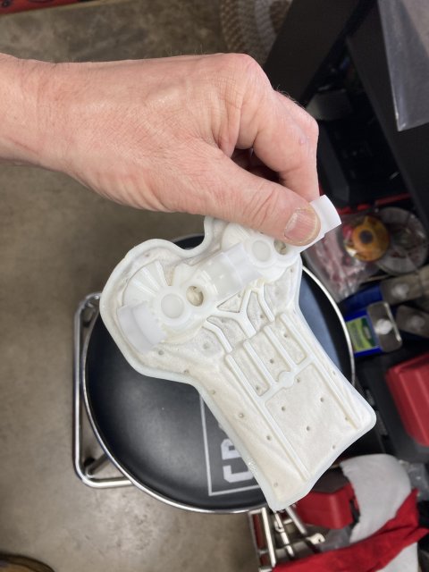

This was his pump filter before
21F1AFB2-8B0C-492B-BBC6-F95D7118EB2D.jpeg 0F50E936-F348-45DE-B211-768F703CA9C2.jpeg 7D54842D-9B2E-4379-AE58-8025CC03E308.jpeg
After
30A751F1-1A23-45A2-BAE2-C8E53F6E0D67.jpeg 1C2D42F7-59F8-4746-BB0C-5BB847833D8E.jpeg D2F89928-3E84-47B5-A220-E0CD40A0BD7B.jpeg B5D23354-11F7-41BD-B79B-46BDFC80E91B.jpeg
I unfortunately didn’t take any pictures of the screens, they’re small only about 3/8” in diameter so not much area and easily blocked. As their intaking unfiltered fuel from the PS side pick up.
