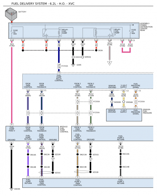

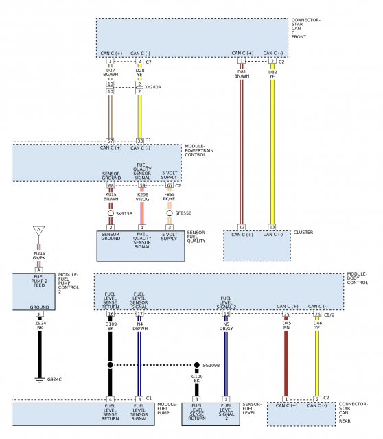

First cleanup and some details. I thought the sensor on the pass fuel rail was the FF sensor but some say no?
That is 100% the Flex sensor
According to everybody's favorite tuner to hate lately it is a sensor however the ECU references the inferred tables using that sensor? Either way I'm not sure anyone has actually dug into it nor actually taken the time to figure out how it's wired into the ECU.
See attached.
See attached.
The hero of the day. Now we just need to know how the tune interprets this information and if that pin may still be active in Prior years and just not used. Perhaps activated by a new OS in which case there's at least an outside chance of being able to retrofit

This is great info! Any additional wire schematics or info on it @Jroc ?
Here is the first page of the document, unfortunately that's all I have.
