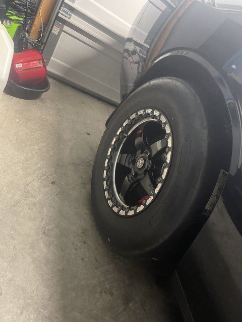

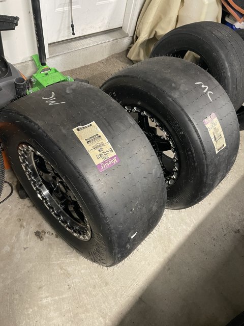

Big bishes on, she #thicc, happy to report longer studs and spacer doing their thing.
F4894513-9DE9-42E9-B91D-90FFDD4A35E3.jpeg 7A0E1C3F-D04E-401F-9683-FFCA636FDF8D.jpeg

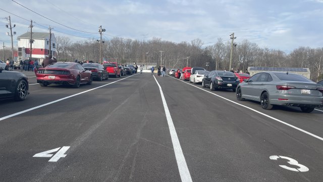

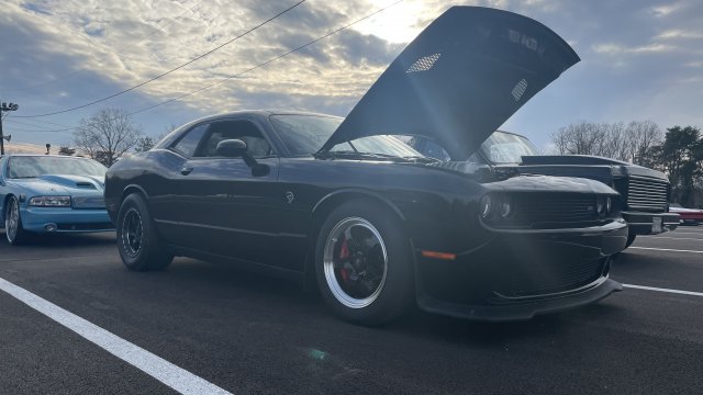

On the last run the car was getting hot, lots of issues in the staging lanes but it was like a freight train rolling down the track. None of the weather matches from last year so this is a hell of an improvement. Comparing the data from last season it is as follows:
9.703@140.75, DA: -842, Humidity: 51.00%, Temperature: 48*F.
The car is loving these injectors, I'm loving feeling competent enough to go in there and tweak. My review of the DBR's is still pending. Learned they behave more like a slick than a radial even though they have a radial compound. Also don't go below 18PSI otherwise they really behave like a slick. Was getting a little "jut" in the ass on the 1/8th cause they were spinning so fast they were folding over. Puckering moment for sure.
Plan to chop up and fabbricobble a video for sure. Since it was opening day the media guys there were all over my car cause with these big ass tires, skinnies up front, some top choice photos are incoming and will put a video out soon.
6711692A-EB8D-4995-BC55-DD2781B40ACC.jpeg C6D1794D-9B40-4209-8D8A-7087D50DC65D.jpeg

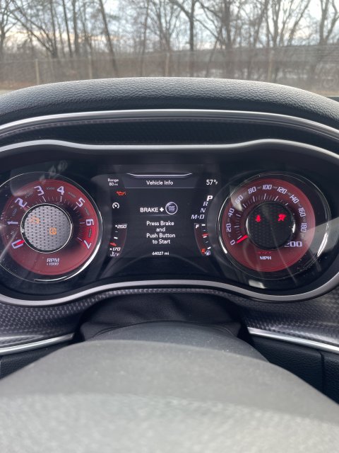

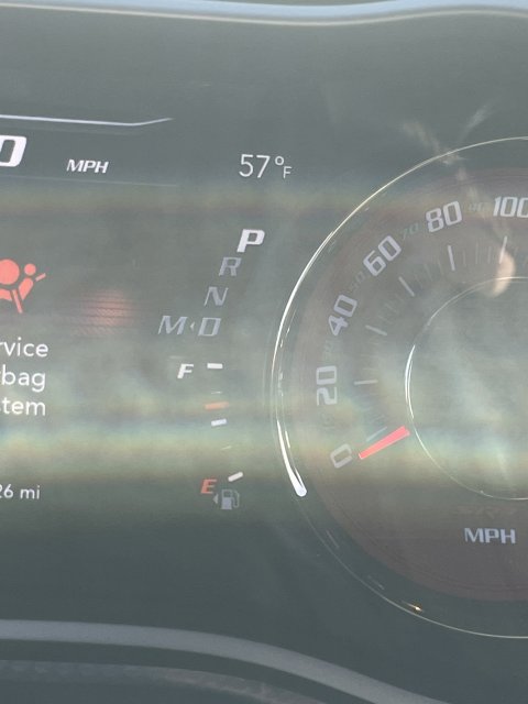

Yea but 120 usually turns to 140 and thats where it will start to pull timing. Trying to avoid that.

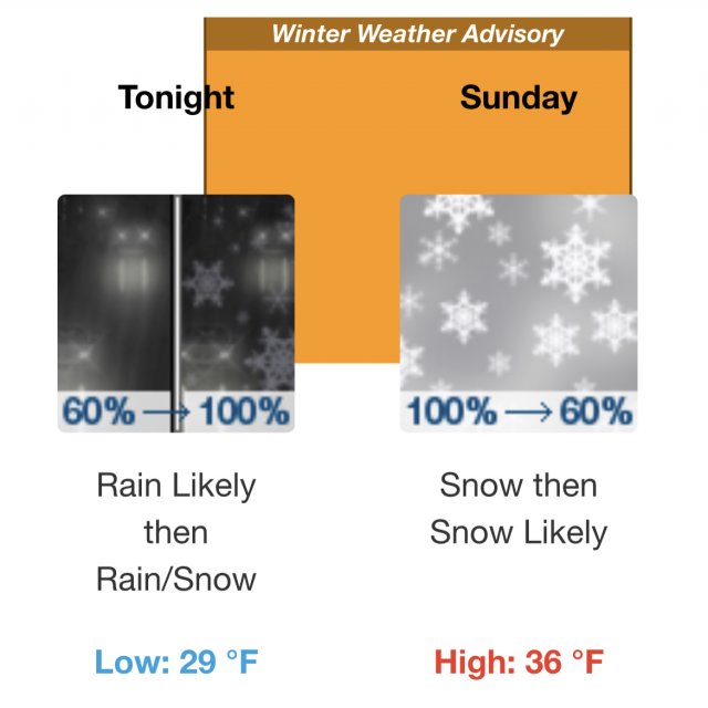

I'm more shocked you don't have snow on the ground in Maryland. We have lots and 20 degree highs right now
You keep that bad juju over there. Tonights forecast.🙃

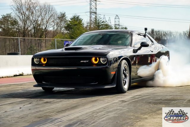

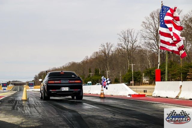

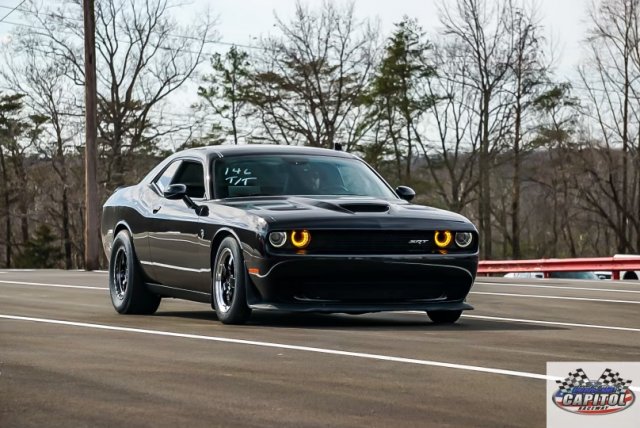

Track photographer went in!
87B08220-C772-4D28-9297-CF05E9459CF9.jpeg EA73778B-4044-4739-B855-1D7DC17457DC.jpeg
