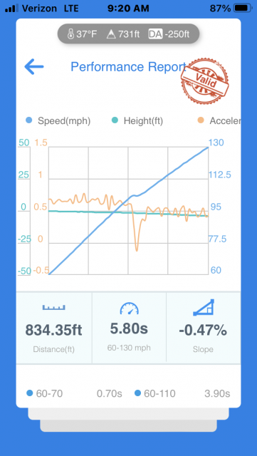

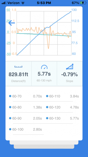

Well one thing is for sure a 2.72 and lower is a nasty combo! Agreed @16GoManGoHC2? :ROFLMAO:
Yes, takes special prep of blower coupling security to survive the combo, but it does produce results! M6 remember
539FDC46-4A71-4A13-8C03-6F0558082493.png F3D7C8F5-9844-4A5B-9ED1-583967BF5AC8.png 023C207A-DA67-487F-B04B-723A3390AC9C.png
4,347
10,782

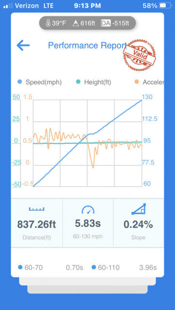

Best part is all 3 have a pause in GPS speed half way through the pull from tire spin :ROFLMAO:
3,510
8,311
thats the 3-4 manual shift there auto guy lol, but yes tire spin can be seen in the orange G force squiggly up and down graph from spinning to well past 100, and sometimes on the 3-4 shift she’ll break loose in 4th on the shift, it’s a fun ride, most I’ve taken on a 60-130 highway pull say no more, once was enough lol. A street 1/4 pull is even more brutal, I need to put a go-pro on the passenger side visor pointed at the seat for when I stomp on it at 50-55 the facial expressions are priceless as they get pushed harder and harder into the seat as third pulls hard for its entire duration lol

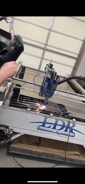

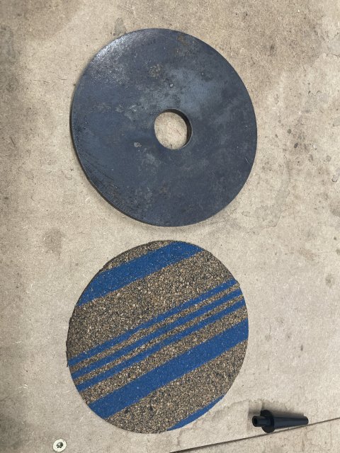

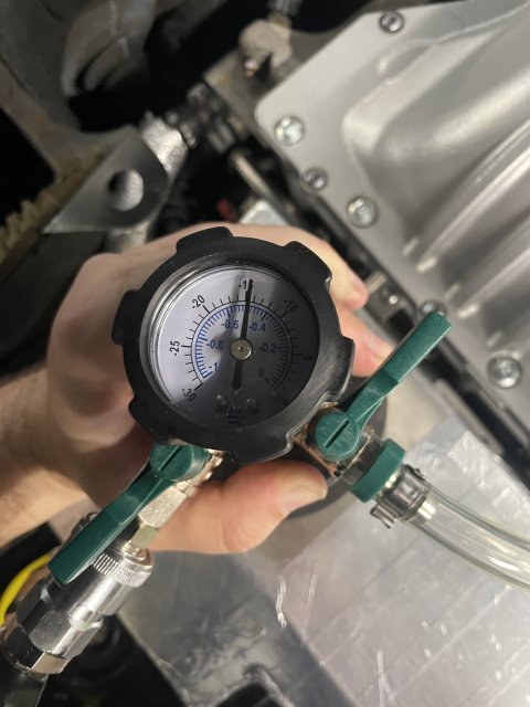

Necessity is the mother of all invention. After doing plugs it was time to do the dreadfull BMR tank fill. Since its almost impossible to put it under vacuum using anything I had a friend plasma cut me a lid. After that I picked up a roll of cork rubber and made a gasket. I got it to 15 psi of vacuum using my little harbor freight. It was a sigh of relief to hear the bubbles hit the tank. Filled

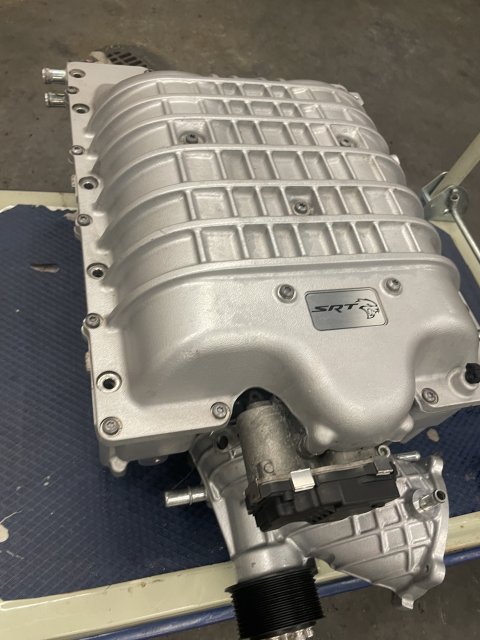

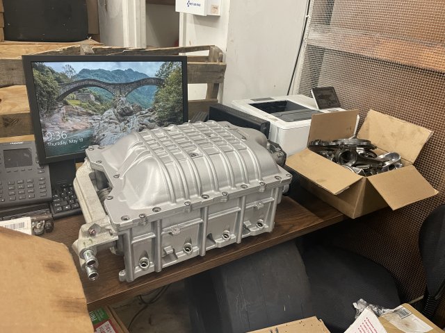

Thread Starter #732

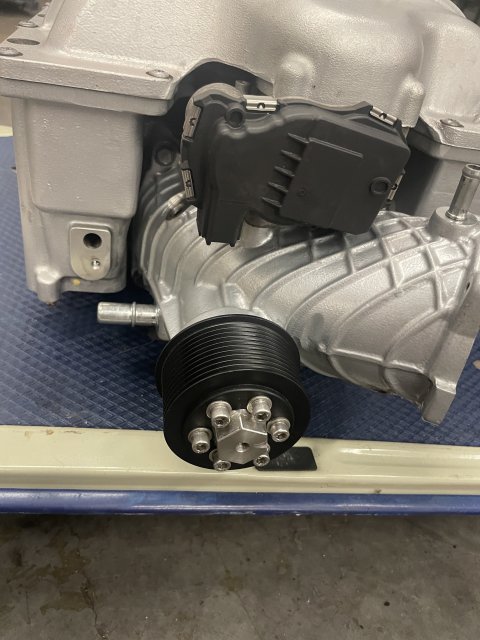

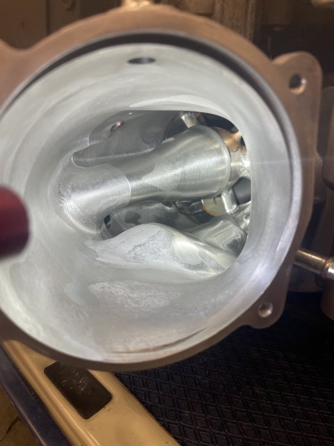

Kong full CNC port, I mean everything. Kong full supercharger race rebuild. Things are about to get fucking nutty. Metco 2.75 so the tune wont have to change.
6A19AA81-56D0-4C37-9001-9329A9EDE65B.jpeg 3C45333A-1C51-4B04-B4B5-CBEB6782E688.jpeg CCD56AB3-F906-4177-87CD-3DA072DB7D2B.jpeg 5CC9F87C-2BD6-4470-9DB4-2C025F67A5E7.jpeg
Sending my current 2.4 to valhalla tomorrow night at MIR. Stay tuned for some live action.

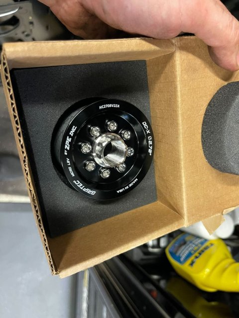

That’s not a grip tech
55,093
185,424
I noticed that too. Figure he will be changing to one
4,347
10,782
He wants to I'm a dealer :p
