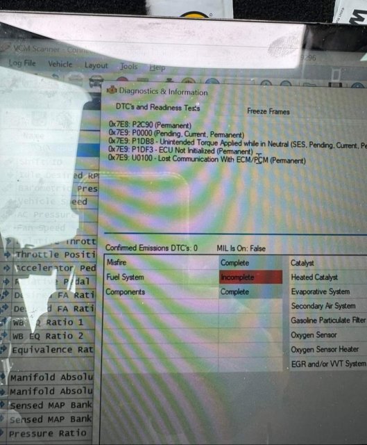

During burnout car went into limp mode and threw these codes. Will only drive in reverse won't go forward at all.

Curious why he doesn’t data log during his passes, can’t see what the car is doing under those conditions, and u fortunately a time slip and video doesn’t really help much for diagnoses. Neither do the codes unless they’re able to see a freeze frame of what other conditions were when the faults set. The dealer will take the micropod (which has built in data logging storage) and try to replicate the conditions, but I doubt they’re taking his car down the track lol
I typically data logged all my passes with my modded cars but this is a bone stock car with no tuning! I just loaded the new Beta HP tuners software on my new laptop but I was waiting on a profile from a tuner I have on see what n the past. With only a hand full of passes on an untuned car I didn’t think I was going to run into issues obviously

I hope they get to the bottom of it, understandable to not expect issues. You can data log on any car without unlocking it, regular hellcat channels should work for it I’d think with HP tuners to see what it’s doing. It’s a shame you weren’t logging, because that could have provided valuable information to dodge and the techs to hopefully find the root causes
