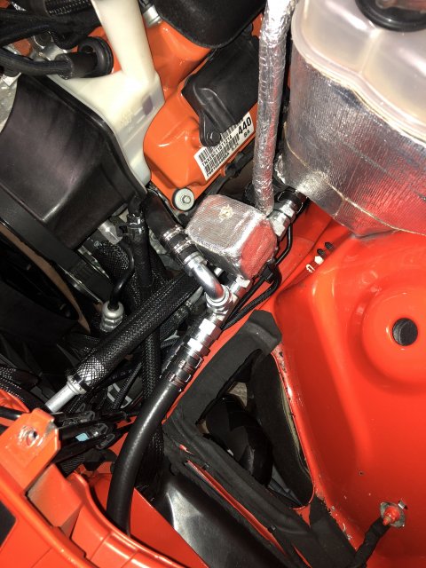

If you care to, and you took enough pictures, you should do a dedicated thread on the installation of this. It might be a good thread to put in the WIKI.
Took LOTS of pictures along the way, planning on putting some thing together so the the many can reap the pains of the one lol.
Here’s a picture of the most challenging fit, the drag valve spliced into the suction so one cut of the hose ended up on the money to T into the compressor inlet. A 45 on the fire wall side here probably make it a bit easier. I’ll be relaying to Kincaid as well so he can customize the Hellcat kit.

Nice solution on insulating the intercooler coolant piping... you've spent a lot of time on insulation. Looking forward to the results.
3,467
8,209
It’s all insulated, every inch of pipe/hose and device, even the pump, has intercooler radiator bypass as well. This is the Larger drag KC unit with a a 1 gallon hopper tank as well so I’m expecting a measurable result!!
