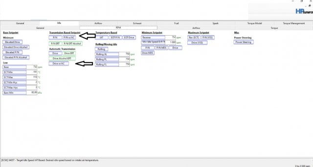

As much as I would love to be able to look I know that my Flex tune is locked which is fine because I don't need to be messing with it. I believe my E85 race tune or some version of it that I have is unlocked though. If I remember tonight I'll take a peek and check those values.

Fired up the tablet and for what files were unlocked that I have access to...it appears that both P/N and Drive AC target idles are set to 750 (752 technically) at temperature. They start much higher during warmup. 1000 to 1300 depending on temp and condition.
I may have deleted all old copies of my open tune files because tbh I messed with them too much and always went back to the known good anyways. If I can't 100% trust my guy I shouldn't be paying him to do it in the first place.
