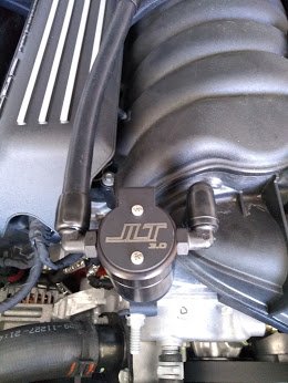

Mine does. Most folks use them on the p/s side and seem to get results with minimal result, if any, on the d/s. Here’s my JLT. 3ED21690-46D4-43A6-93B3-5576E69CB310.jpeg

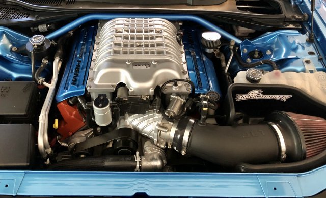

I've got the UPR brand oil catch can - engine block mounted. I even installed it myself - my first step up the mechanical competence ladder of Hellcat success. I get 1-2 ounces between six month oil and filter changes - and I ran a couple of road course weekends. If anyone ever asks me what it is - pretty chrome - I'll be sure to tell them it adds 37 HP.
