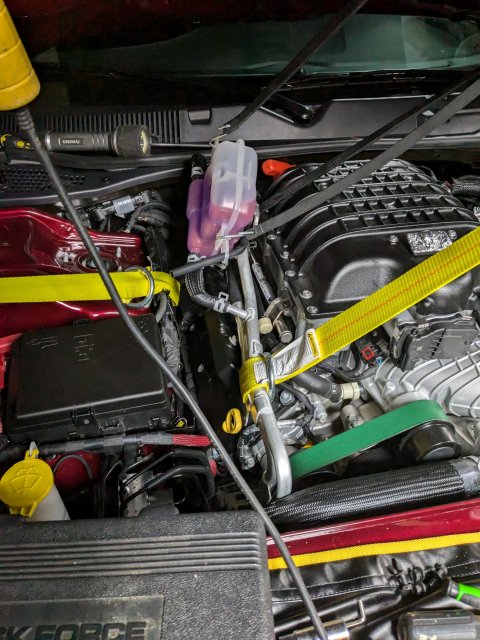

Any tips on the plug change? Mine's still not having any misfires or anything so I'm not sure I can convince the dealer to swap them for me. I'd prefer them do it for record keeping, but also wanna go to 2309s so not sure how that would work. I need to ask them.

Speedy, mine had no misfires or codes but the plug gap was between .032 and .036 on all of them. The TSB requires that tech to duplicate the problem, so I was not going to deal with that since the car ran good. Tech would take my car out, beat on it and say that there is no problem (potentially). Plus, the Champion plugs gotta to go, imo. For these reasons, I installed NGK 2309 and gapped them to .024 (as stated in the TSB). Everyone I know who has a 170 and checked the plugs has the wrong gap. Not going to drag the 170 with crappy plugs that have the wrong gap. The passenger side plugs are a real challenge to replace.

All you need are the wobble 3/8 deep magnetic spark plug sockets and it’ll make quick work of it. 15 minutes or so to get them out. Small 1” wobble extension and a long one, but most of them will come out with just a deep 4” wobble extension built into it. It’ll put your socket wrench right above the above the valve cover. Taking the coils off and moving intercooler reservoir is a different story

I also have these which make quick work on all other cars I've done plugs on life savers they are: https://amzn.to/4dxxAWR
I've pulled 2 or 3 plugs outta mine and they were .031 to .032 but I only checked a couple easy ones outta curiosity.
I was thinking if you wanted to play strictly by the book a coil unplugged would set off a misfire code I think?

The ratchet on the black box and wire is a new one. I left mine disconnected from the firewall last time I did them. I shouldn’t have put the black box back on when I replaced my headlamp to dash harness.

When I do mine again I’m gapping them to .021 and not thinking about them again

I'm literally contemplating dropping the K member out to do a short block just to shortcut the spark plugs again
I would if I had a lift

Hardest part of doing the plugs is getting that damn black plastic box on the pass. fender out--the one that does /nothing/ but get in the way. Rip it out and throw it out. Once that's gone, access isn't too terrible on any of them.
