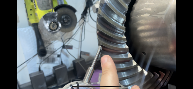

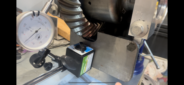

Diffapalooza 2.0 these instructions are for differentials that aren’t blown up and pinion doesnt need to be cleaned.
Step 1: Remove cover, 16mm and 12mm bolts.
Step 2: Inspect cover clean
Step 3: Install TBA machine bottom plate and carrier caps. The carrier caps are torqued to 120ft/lbs. Reference: Install the bearing caps and torque them to 120ft/lbs and check the back lash on the ring gear. It should be between .003-.005”. Brand new housings from Dodge are right at .004”.
Step 4: lock pinion flange in vice
Step 5: ensure that dial indicator is not contacting other teet
Step 6: move ring gear slightly and measure movement
Seems this diff averages around .004. This is not rocket science but its close. No stores had marking compound so Ill do that tomorrow after a visit to Napa. Start disassembly and cleaning. Maybe even get the ring gear off. @zhc you ready to show the world what clutches from 7s passes look like?

I had to remeasure backlash. Glad I did.
3,518
8,330
Was going to say your indicator needed to be perpendicular to a tooth profile but you got it 👍🏻👍

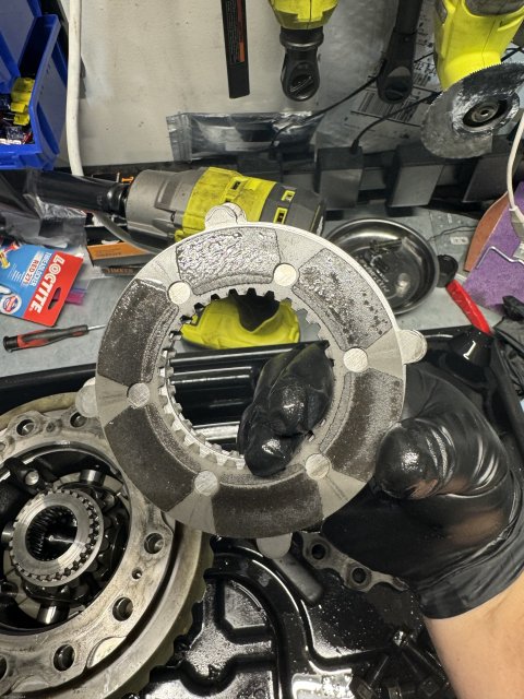

@zhc has a factory freak. Immaculate clutches and steels.

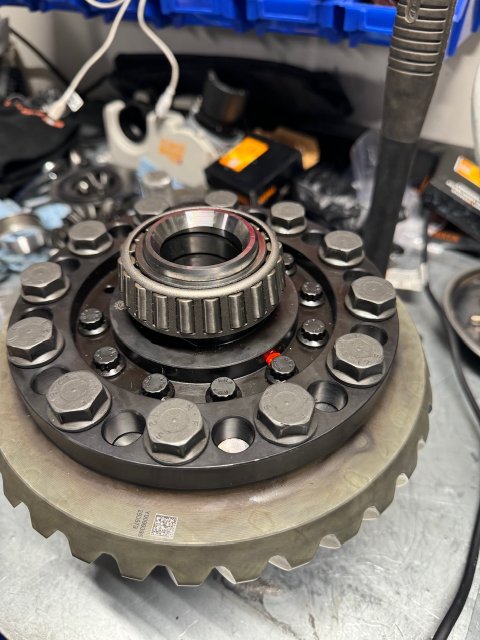

To remove the ring gear no heat is required.
Smooth controlled burn outs with both wheels spinning is the key.
Those clutches burn up real quick when only one wheel spins and you don’t realize it.
One way you can tell you’re only spinning one wheel is your speedometer will be reading much lower, like half or less than expected for the rpm and gear that you’re in

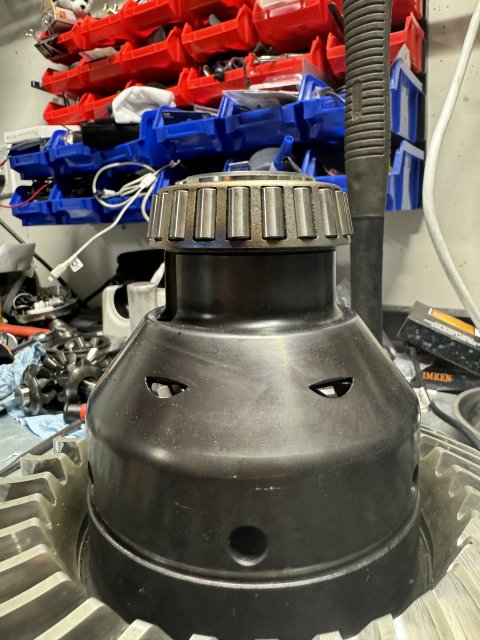

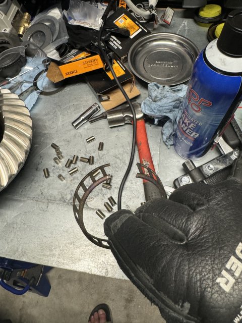

300*F in an oven for an hour, slid right on.
300* in an oven, stopped half way, pissed me the fuck off.
improvised and cut an old bearing open, ground out some of the interior and used mechanical persuasion
final assembly tomorrow (shims, final ring gear torque, housing assembly)

I wonder if you froze the entire carrier to contract it and heater the bearing to expand it would have worked. I had to throw my pilot bushing for crank in freezer overnight, then slid right in
