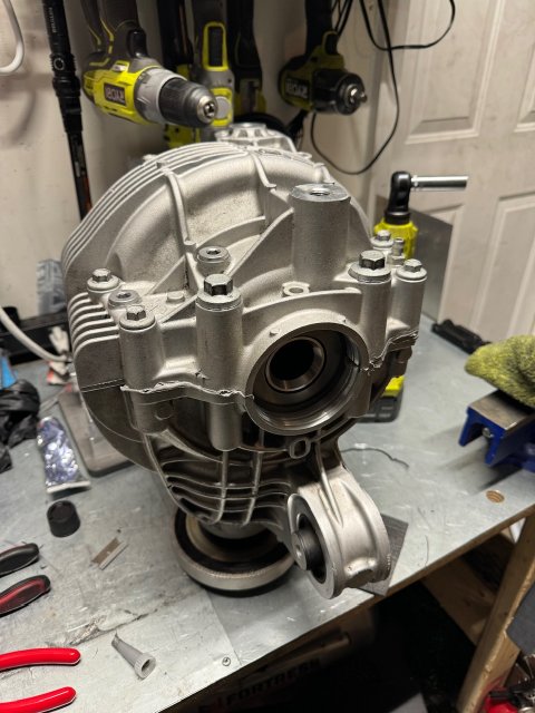

There are no published torque specs for ring gear. It got red loctite and ugga duggaz.

diffapalooza 2.0 is complete
3,915
9,665
Thread Starter #1,866
For reference and reference only. The original outermost shims must remain the outermost shims. To get close to the .004 backlash I went with one medium shim and two thin shim on the passenger side. One medium shim and four thin shims on the drivers side. Be generous with the rtv. Tighten a little and let sit for an hour. Come back and final torque. Small bolts 40ft/lbs, big bolts 90ft/lbs. Let cure for 24 hours.
Final backlash reading, couldn’t be fuckall bothered to try and get .004.

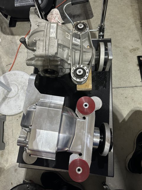

I used my harbor freight hydraulic cart for the diff, made it pretty easy. Then again I have stock axles so comes out easy. I want that little red transmission jsck, would have give me more room I think

This little cart? Same one I use to swap my rear this weekend. Works like a charm. IMG_7909.jpeg
7000 Posts Club
7,542
6,297
Yep! Same exhast
This little cart? Same one I use to swap my rear this weekend. Works like a charm. View attachment 116459
yep! Same exact one. I use it for the transmission and exhaust too
