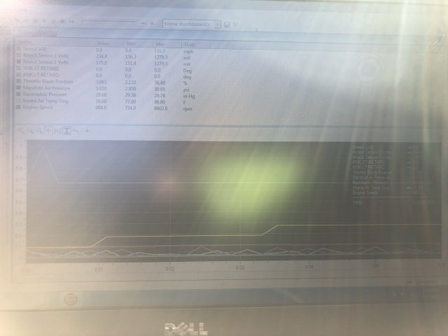

M6 17” 315’s 2.85 pulley, 93 pump gas and a qt of Octanium, couldn’t get under a 10.8, was hoping for mid 10’s but on a cold track with very little sticky sauce and first time out this year and didn’t break anything I was a happy camper driving home.
Logs showed a happy engine, low knock sensor volts and no timing pulled, could probably lean on it a bit more but next up is FAS Billet blower plate and ported snout so we’ll see what knock sensor volts look like after that. 72B52059-3C54-4641-BC25-3782ABF0CA46.jpeg Made 11 passes, first 2 11.5’s , lowered tire pressure from 28 to 20 then 18 the balance of runs 10.8 to 11.2’s. The Drag size Killer Chiller helped I’m sure too with some runs being only 4-5 minutes apart. IAT’s never went over 100 but it was a 55F day as well.
Logs showed a happy engine, low knock sensor volts and no timing pulled, could probably lean on it a bit more but next up is FAS Billet blower plate and ported snout so we’ll see what knock sensor volts look like after that. Made 11 passes, first 2 11.5’s , lowered tire pressure from 28 to 20 then 18 the balance of runs 10.8 to 11.2’s. The Drag size Killer Chiller helped I’m sure too with some runs being only 4-5 minutes apart. IAT’s never went over 100 but it was a 55F day as well.
Logs showed a happy engine, low knock sensor volts and no timing pulled, could probably lean on it a bit more but next up is FAS Billet blower plate and ported snout so we’ll see what knock sensor volts look like after that. View attachment 13823 Made 11 passes, first 2 11.5’s , lowered tire pressure from 28 to 20 then 18 the balance of runs 10.8 to 11.2’s. The Drag size Killer Chiller helped I’m sure too with some runs being only 4-5 minutes apart. IAT’s never went over 100 but it was a 55F day as well.

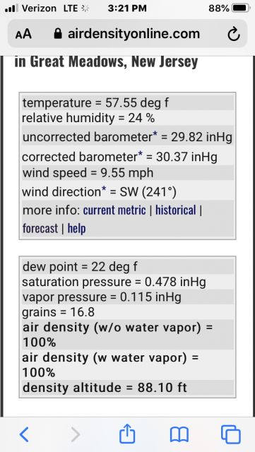

DA was -100 earlier in the day, about 80 when I was running

Yea, I know, just had a bad tank of fuel that was causing high knock sensor volts and 1-1.5 degrees of STK. It’s why I data log and check for knock often, especially after a fill up and especially mid winter with winter gas and old gas in some stations tanks. It’s a crap shoot for sure, I was burned once by bad fuel and through a misfire code and melted a plug, never again, I watch diligently now!! . If e85 was around me I’d put the 10% lower on that still sits in the box and get a set of FIC 1200’s and OST’s double or trip pump system and ROCK but I Street play with my cat often so I go through allot of fuel, too much to pump from a drum for me. Someday!!
