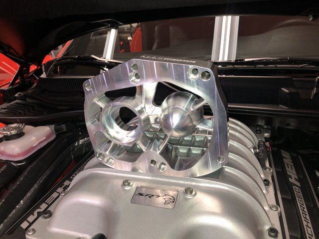

Putting on a FAS billet inlet plate this week myself, will be trying that Fastman TB on stock snout first before porting a snout and going with a bigger TB someday if this setup doesn’t net 50 additional HP
I would love to see what the plate adds by itself. I really believe it needs to be with the snout and TB to get the "best" gains. I'm kicking myself for not putting it on this round with my snout and TB. It frees up enough airflow to require tune adjustments and will add some boost.

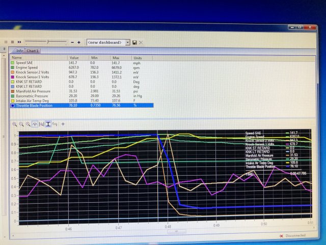

I just did about 3 weeks ago a before this upgrade dyno visit and plan on doing a after it’s installed visit and then possible another dyno visit if and when I port the snout and go with a 105mm TB. I’m one that like to know and prove out gain claims. I’m making about 17 psi now with a 2.85, I’ll be able to tell pretty quick based on data logs alone how much more boost the plate alone with the FM TB nets. I’ll be posting the data. This data log taken earlier today, if I’m looking at this right max boost was about 17.24 psi?? D20A4B40-3832-4B29-A373-9B2D172FAE0C.jpeg

Looks about right.

31.53 manifold pressure ..I thought was 16.5
3,470
8,211
Have to subtract barometric pressure, by converting in hg to psi, 29.20 in hg = 14.34 psi, 31.53 psi - 14.34 psi = 17.19 psi of boost pressure. That’s how I was told to calculate it at least
I always subtract 15 from my numbers
3,470
8,211
14.7 would be a better number to use as a constant, 1 atmosphere, very seldom is barometric pressure that high, it would have to be almost 31 in hg to be 15 psi
